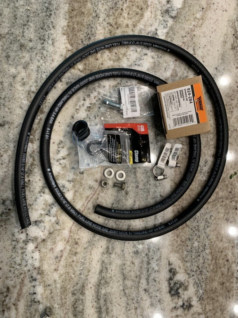

    These were the individual parts used to relocate the breather on my 3G.
