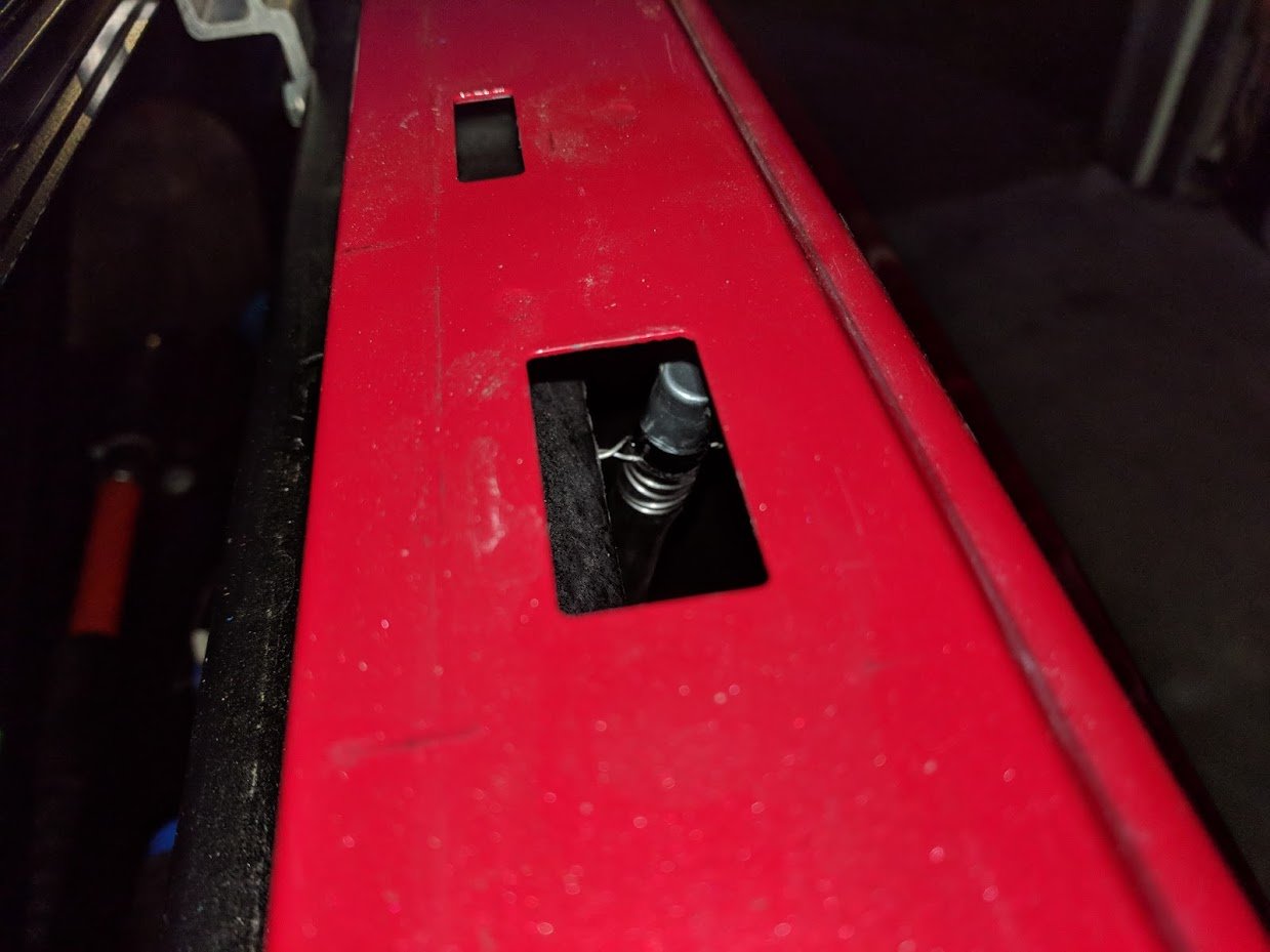

    This the only pic I have at the moment:
    DON'T go with that location. I didn't have any VHB tape and a zip tie support on hand. If I did, I would have just stuck it to the bed behind the filler. I did this because I didn't want to drill into the fuel filler surround and didn't want to drill the cubbies since I have them sealed and full of stuff.
    Someone posted a pic where they routed theirs behind the taillight. Great location, IMHO.

    I wonder if it's machined prior to welding axel tubes on and it's warping from the heat. I routes mine behind taillight. Only downside I can think of, is it's not as simple to check on.
