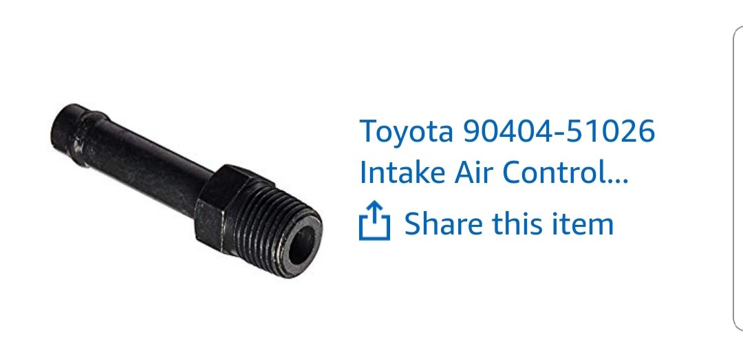

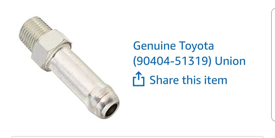

    I ordered the parts mentioned in other post here on TW and last week I decided to do the mod.
    I removed the left rear light, routed the hose and removed the factory breather, it came off fairly easy. When I tried installing the new one it wouldn't go in no matter what, not even even one tread. I tried many times and my neck start hurting so I decided to call it the day and install the old one back. It went in really easy just screwing with my fingers a few turns, used a wrench to snug tie the union and it would just turn and turn and turn and never get tight. Tried to revove again and would just turn and turn and it wouldn't come out. It pretty much turns both sides without getting tight or unscrewing out.

    Pic of the union?

    I bought a second one to try after I remove the factory, if I can remove it.
