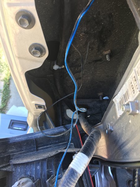

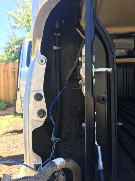

    Performed this mod while I had my truck up on ramps for the 30k service. Ran the breather to behind the driver's side taillight. Should keep it out of the rain and about as high as it can get. I don't like the under-the-gas-door installations for rain potential (probably unfounded), and I have a cap on the truck for sleeping in it, so the cubby installs didn't make sense either. At some point I'll get back under there and attach the hose to the bottom of the bed a bit better.
    uploadadventure, Stew22 and RobP62 like this.
