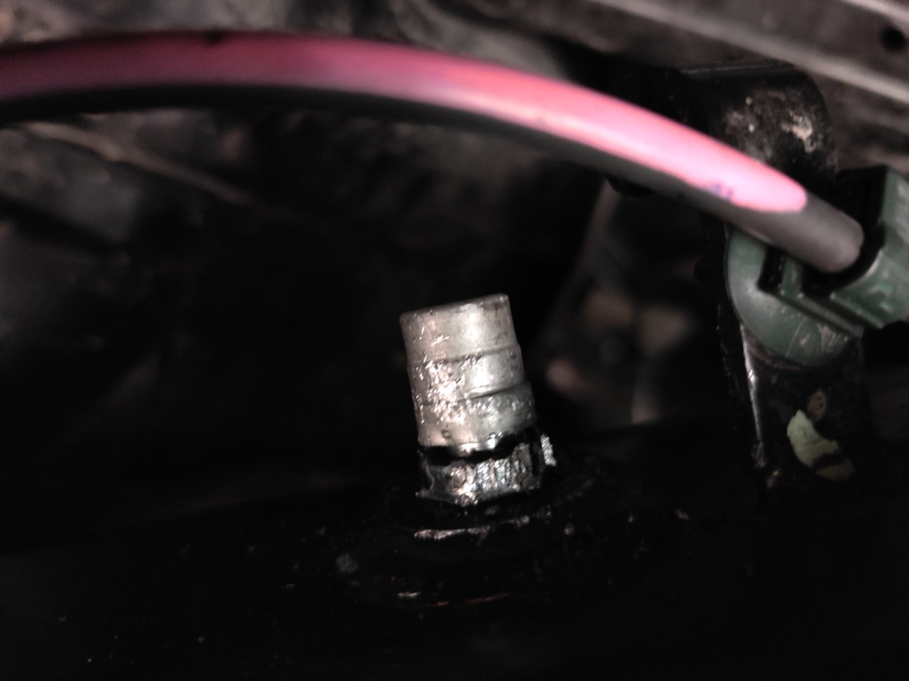

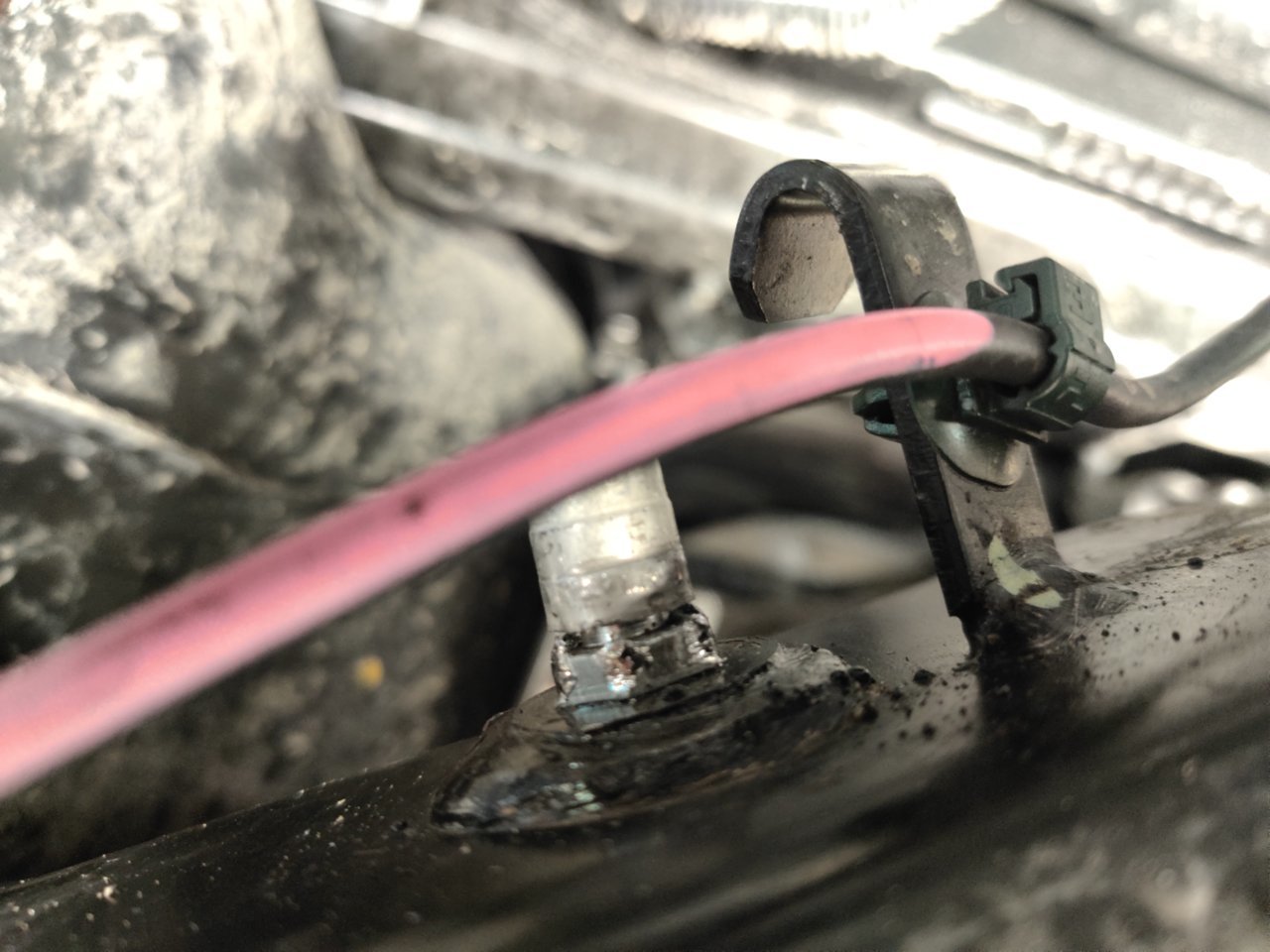

    At this point, vice grips or rounded nut extractor. You'll destroy taking it out anyway so vice grips are probably cheapest option. The whole thing is aluminum so you'll chowder it up. Just curious, was yours showing threads before you started taking it off or was it all the way down to the case? Mine was all the way down and it was tight as hell to break loose.

    It is still there and the nut is thin. I had to pack up because I was very tired and so soaked. I will resume the work next weekend and hopefully the weather would be nicer. The extractor has to be deep socket, not regular that fits the top breather through the deep socket. I will check hardware stores this week.

    Yes i picked up vise grip and tried it but the breather nut is worse. See the latest pic. I will resume next weekend.

    You might want to pay someone to remove it

    At this point put the OEM hose on and regroup lol

    I had to do this on my 1st gen. The breather rusted closed and was building pressure up in rear diff. I noticed cause oil was bypassing the pinion seal. Truck also 217k when the problem showed up. Easy and useful mod

    this is the only way I was able to removed mine once the same thing happened to me

    With the stuck breather nipple, get yourself a Ridgid 6" pipe wrench vise grips can only grab so hard before the jaws and lock bars deform, a pipe wrench bites tighter the harder you put pressure on it you will get it out even if you have to use a cheater bar on it.
    I used my 6" pipe wrench with a 2' cheater and a hydraulic jack to remove a drain plug on a jeep once no issues.
    https://www.amazon.com/gp/aw/d/B0009GF3YS?ie=UTF8
    That has pretty much replaced all my vice grips, own 3 now one lives in the truck permanently.
    Saved my ass many a time especially good on little rusted crap.
