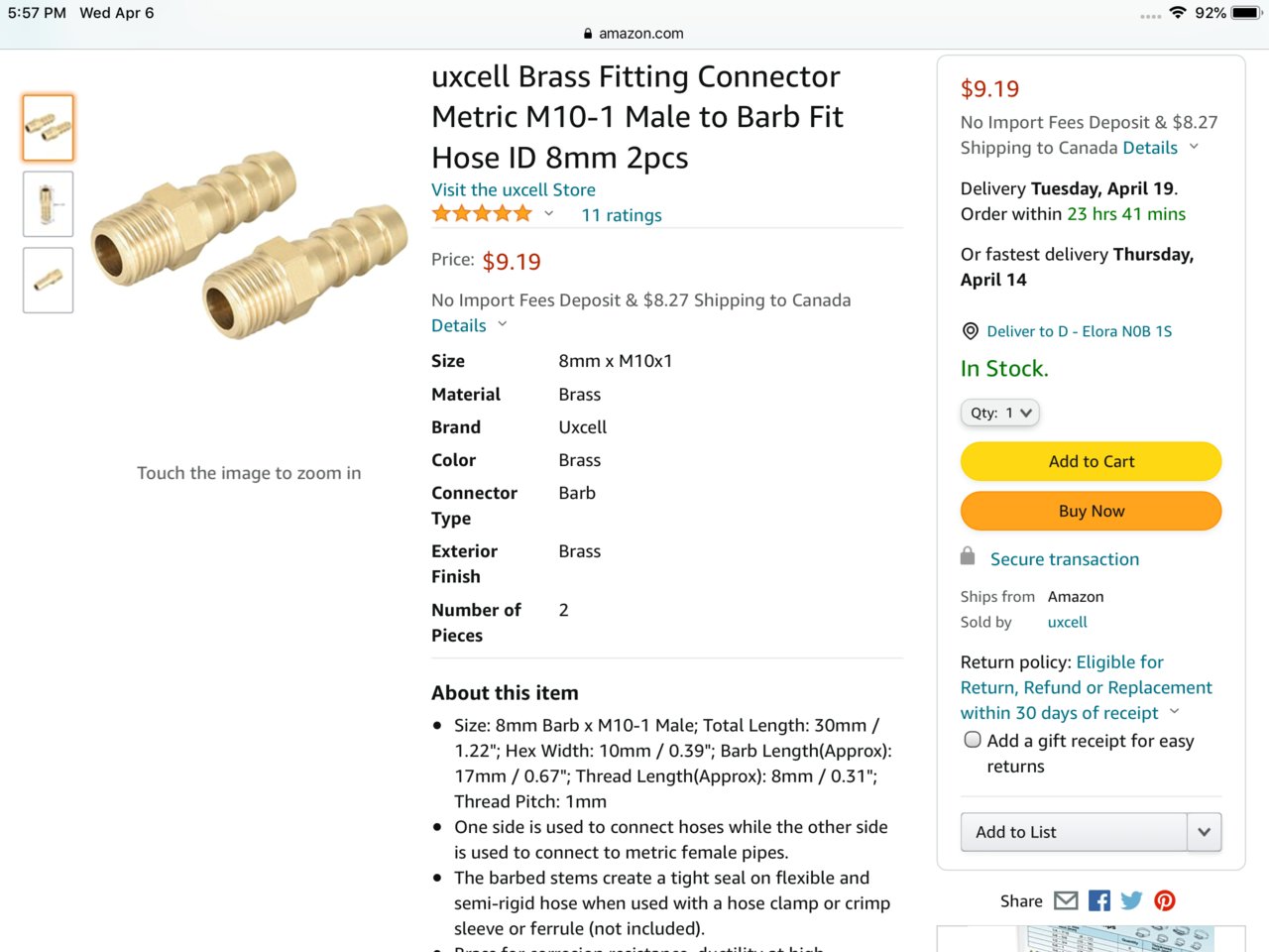

    Anyone source the diff hose fitting from hardware store ? Isn't it just a barbed fitting and assuming the threads are metric.

    I just got it from the auto parts store. 5/16” fuel line.

    Mainly wondering about the fitting

    Cheap(non-fuel injected) 5/16”ID rubber fuel line fits perfectly on this barb with a SS hose clamp....
