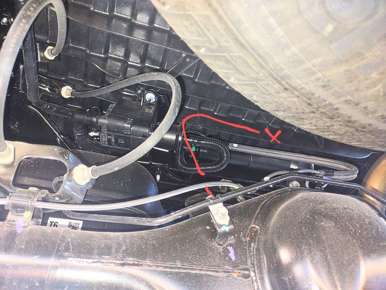

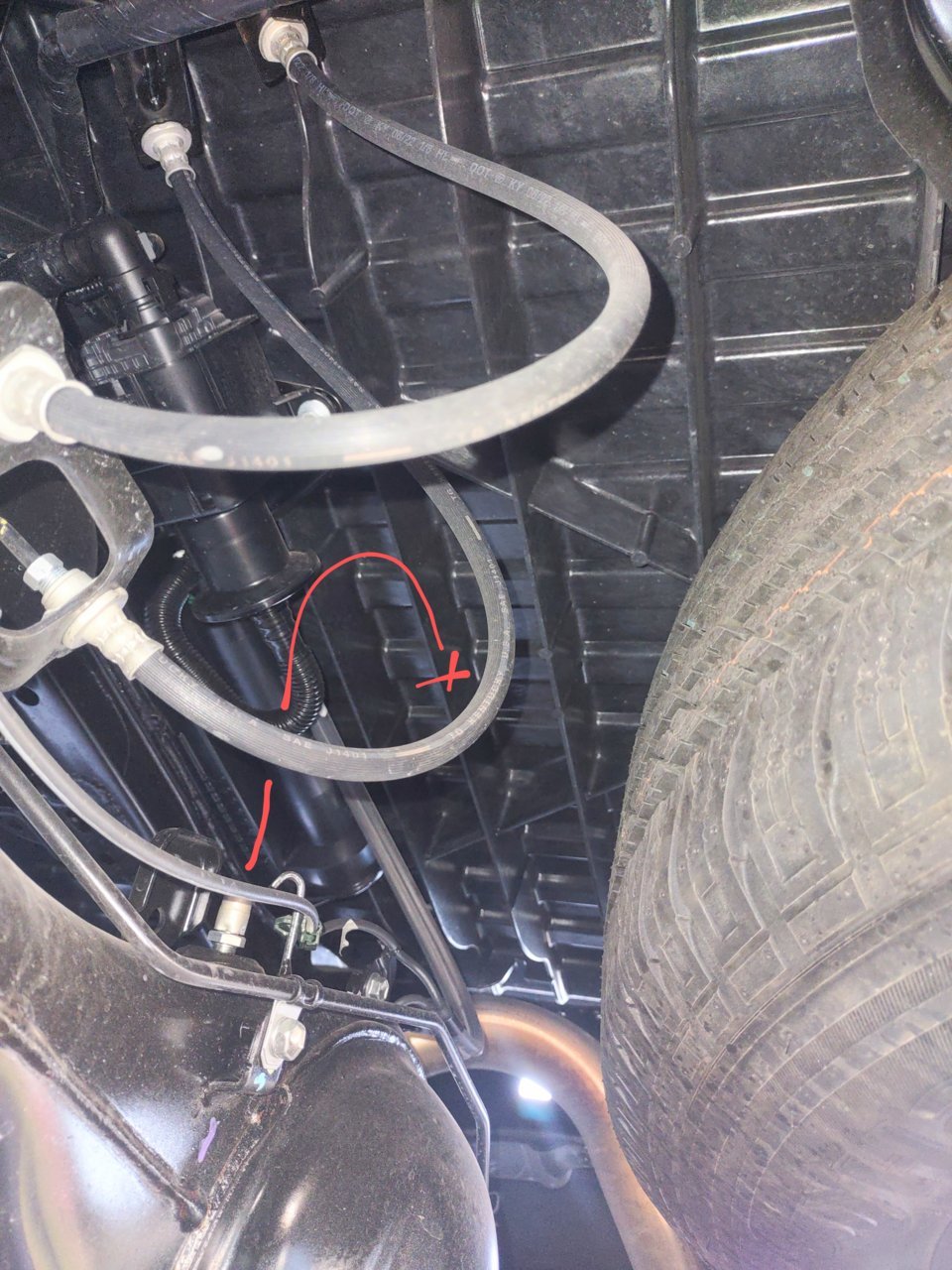

    Thanks...this is my idea, puts breather at bed level, tire could be completely under water and still out of reach. IMG_20220923_080805131~2.jpg

    Thats not too bad of a spot, most people either relocate it behind the driver side tail light or if you have the driver side bed cubby thats where i mounted mine. You can also part out your own kit or by a kit like the ARB one which is what if did because im lazy lol.

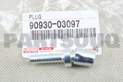

    "NOTED" thanks can anyone confirm this is a 2 way.....

    It’s not. It’s a 1 way.
