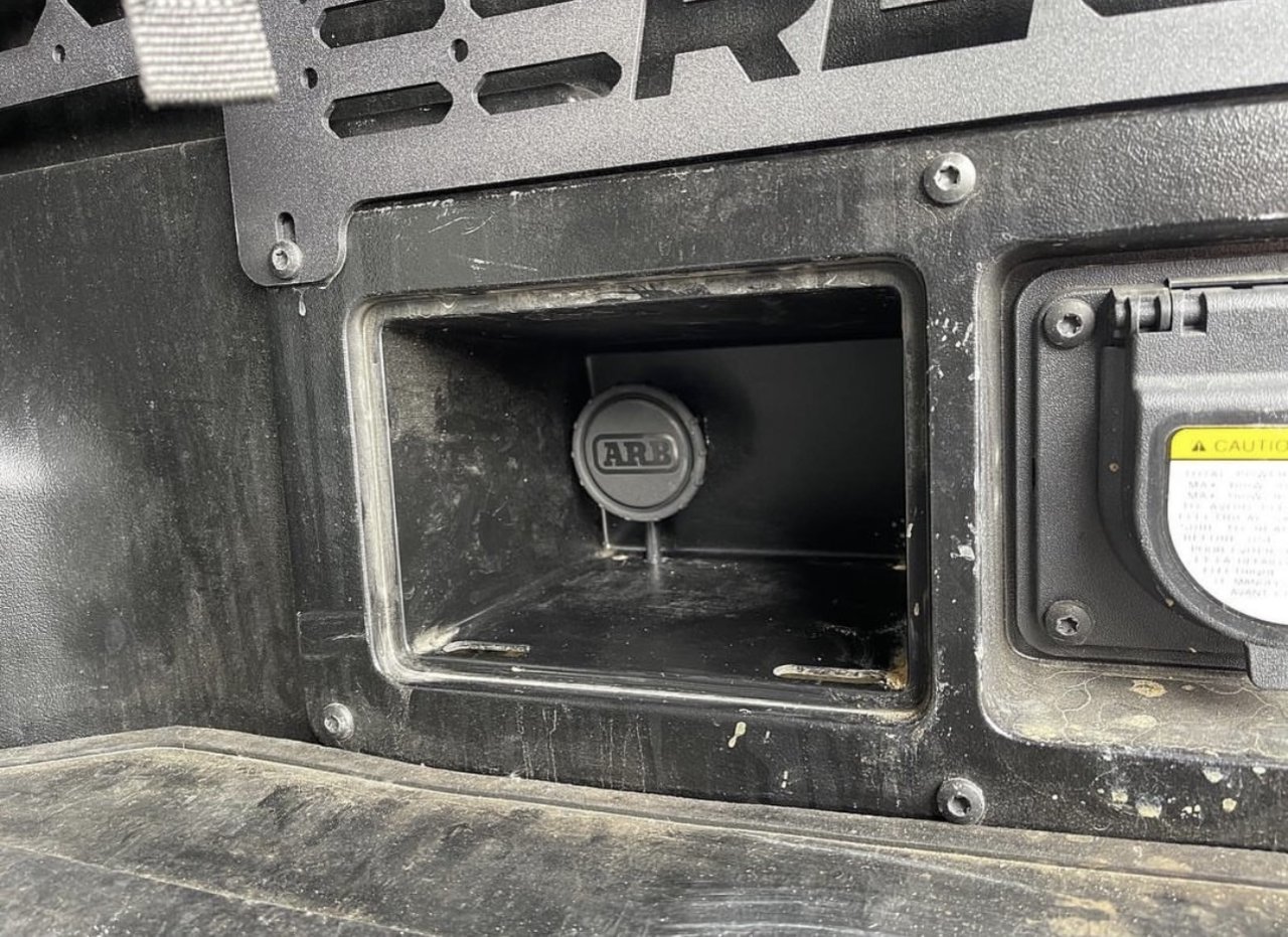

    Easy to install and you have options on where you want to install the breather. I installed it in the bed cubby. 60CEB89B-E3BD-4BF3-BD2F-FC19FBB70869.jpg
