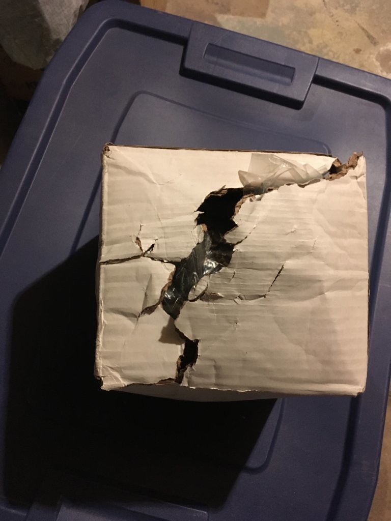

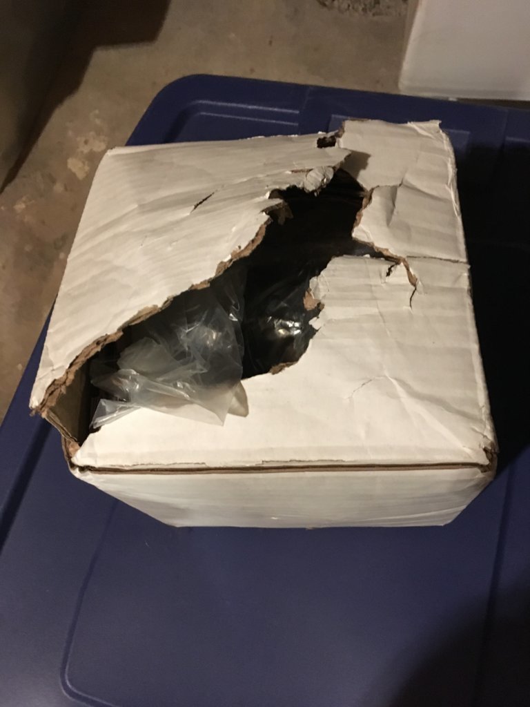

    Ive never shipped a diff, but that looks like a triple layer box with padding.
    1000% better than anything Ive ever received from Amazon haha

    Just so y'all know, ECGS told me to run it. They quickly sent out the lost clamshell bushing and front seal first thing this morning.
    I cleaned it as best I could with brake cleaner and lots of compressed air and will install it this evening. I just gotta remember to spill some yellow paint to Mesh, the patron saint of pinion lash.

    A scrape isn't damage on a non-machined surface, it's a scrape. Doesn't affect the operation. Yes, it's unfortunate. It should've been boxed better and UPS is very careless with packages, considering what they're paid. But then, what they're paid is part of the problem. To cover that cost, management pushes to move more packages faster...leading to this.

    Inappropriate packaging 100% but in all reality it's probably just fine. Good(?) news is it's at least documented there was some questionable shipping prep and they told you in writing to send it anyway. Now, if there is an issue, you'll be dealing with ECGS rather than UPS, which is actually most likely the better scenario (not that you'll feel that way dropping that pig again if you have to).

    Best way to ship a differential is in a plastic tote. Get a garbage bag, fill with a can of spray foam. As it's setting, place the differential into it to create a mold. Once it hardens, place the diff into it, then spray into another bag and do the same for the top. Close the box so the foam expands all around. Even a good cardboard box with spray foam/garbage bags will take a serious beating. I've shipped a few that way via UPS and never had an issue.
    Edit: I see OP definitely packed properly, ECGS should have used that packing to return the diff.

    Both my diffs from ECGS arrived just fine in similar packaging. I reused it to send my cores back in. Each one was a thick box within a thick box, stapled, and a bunch of sturdy shredded cardboard filler. No room for anything to move around in there. That box must have been dropped from a shoulder-level height to get that damage. Maybe it could have been packaged better, but I'd put this on the shipping company.
    As others have said, it is likely just fine. Those things are pretty sturdy. Unless it hit directly on the pinion flange at an angle, there's not much that could be damaged. It doesn't look like it hit on anything that could cause an issue. Any debris will get washed out with the first oil change at 500 miles. But, ECGS will likely take care of you, whatever you decide to do.
