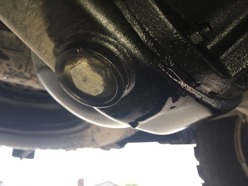

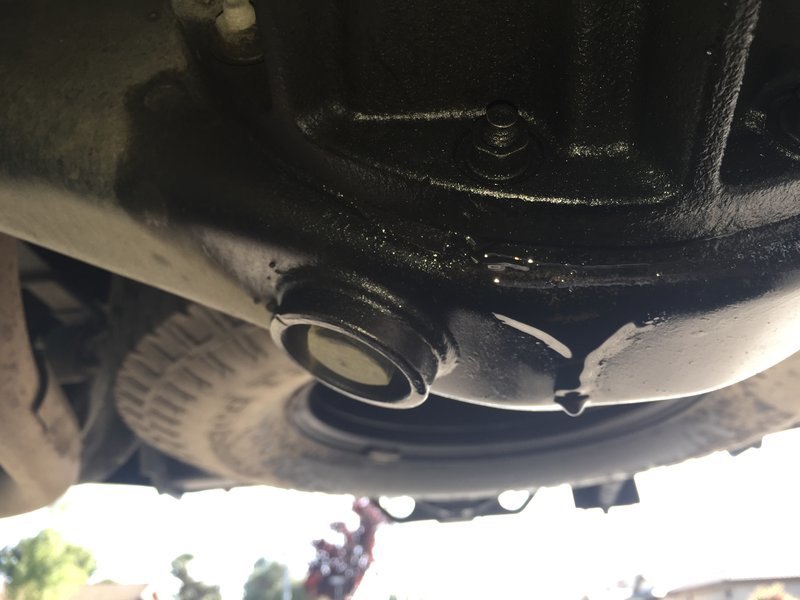

    Got a bad drip coming out of the front side of my rear diff. Going to take it to the shop tomorrow am but wanted anyone's input on the situation. There seems to be a bit of gaskeT showing where the dripping is coming from. Thanks for the help!

    I would just drain it, pull the third member then reseal it.

    Check that none of the nuts holding the 3rd on are loose. Check that the breather isn't blocked or loosing oil out the axle seals into your brakes. If none of that is happening, then you'll probably just need new gasket

    Pinion seal? It looks like it is trailing back.

    ETA: upon further inspection of your pictures it looks like your lacking sealing material between your 3rd member and axle. You'll have to drain, pull the 3rd member, clean, re-seal then fill.

    I tightened mine down and there's no more leak 24 hours later, still a little confused how they got to be finger loose

    FYI looking in the service manual those bolts are supposed to be at 18ftlbs

    Reseal with RTV. The stock gaskets don't cut it on our 3rds with how much torque they handle
