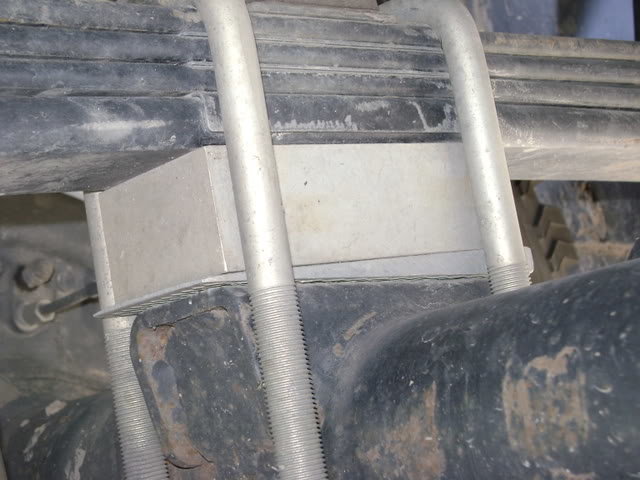

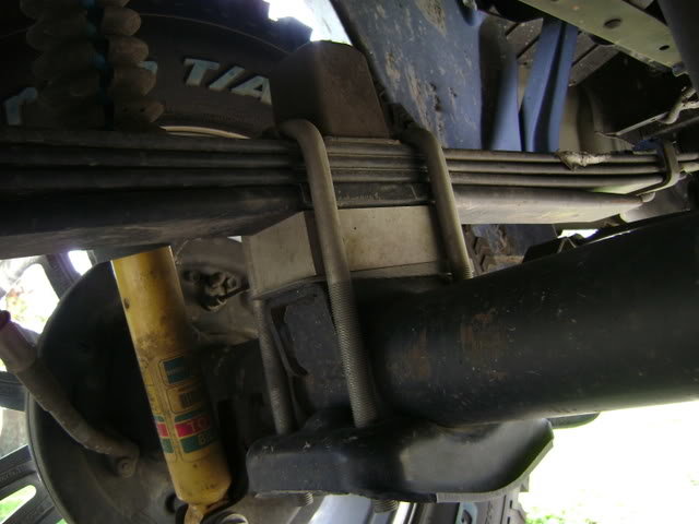

    This is what I have in the rear, under the block is the diff shim

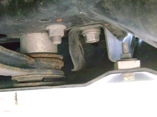

    Here is the front diff. drop and skid plate drop. Diff is Round and on the left skid is square and on the right in the picture.

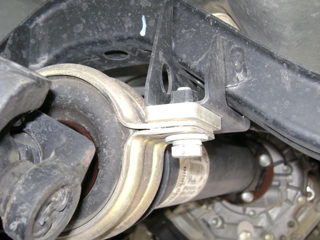

    I also have the one for the hanger bearing
    This was a toytec lift with drops.
