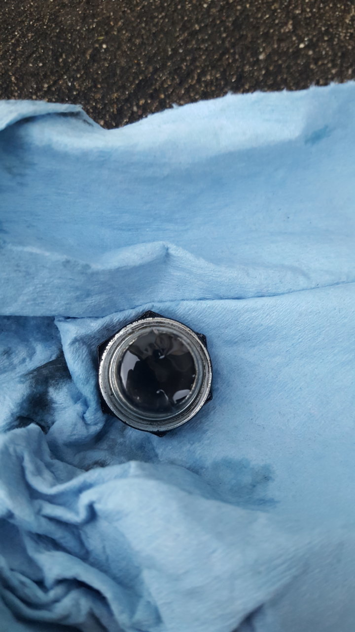

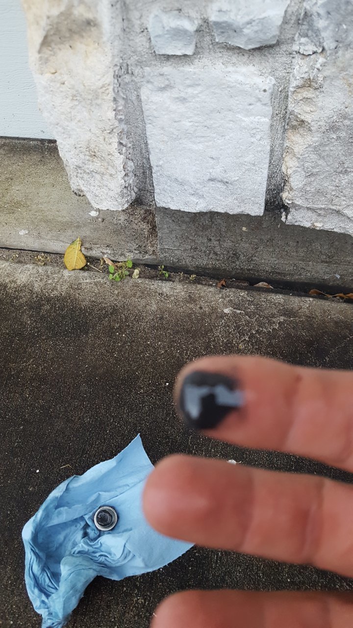

    Even though the book says to change it every 30,000 there's no way I would leave the initial fill in there for that long. Haven't had a chance to do the front differential yet but the rear diff had a silverish tent and a ton of shavings on the magnet. The transfer case was very dark brown.

    That's was how mine was as well; sludge-like build up, but not metal on the magnet thankfully. Although, like an idiot I waited for the 30k.

    sludge is worn metal and oil deposits

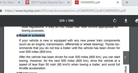

    Only "break-in" I saw on the manual was about towing...
