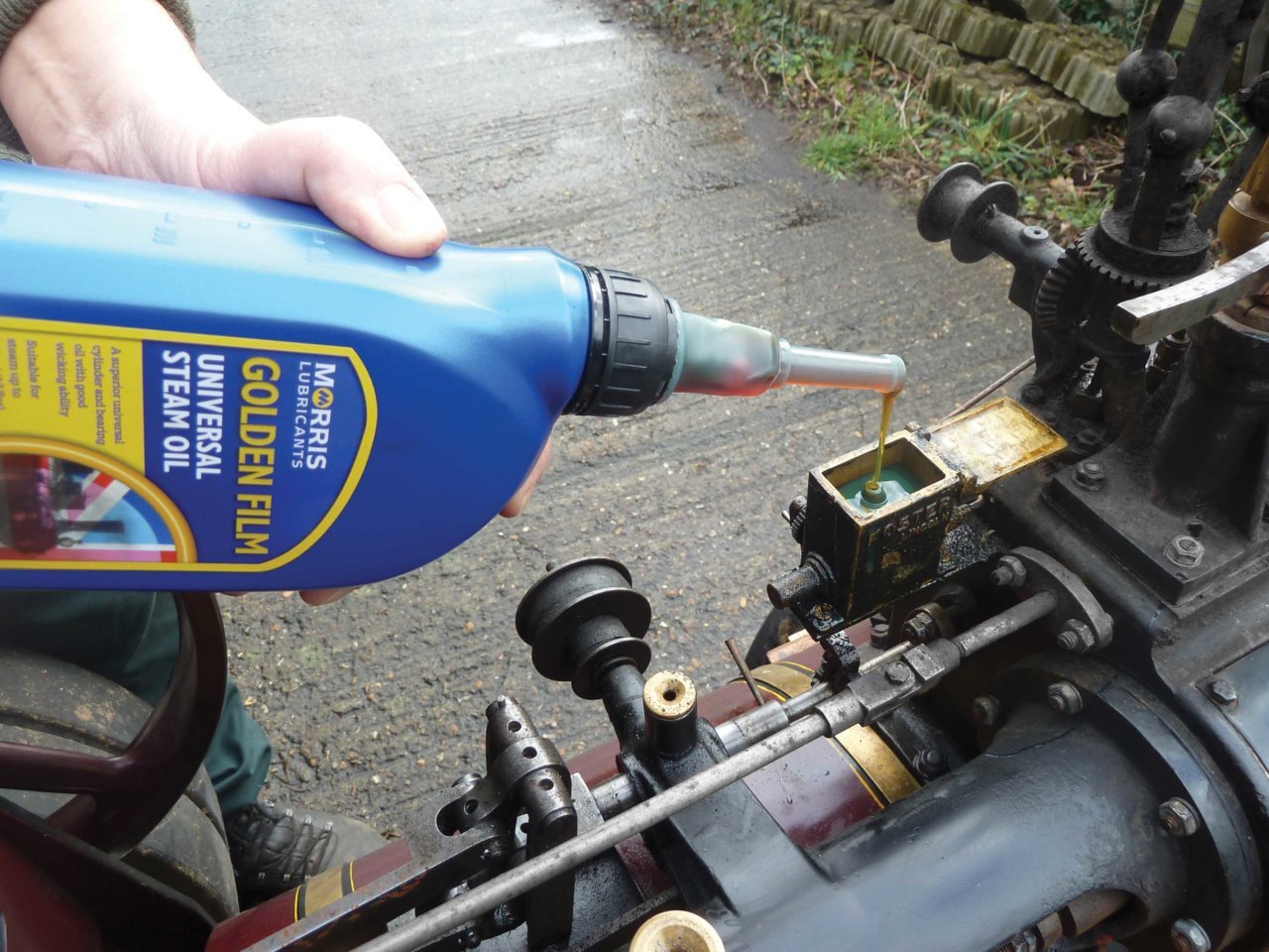

    I set up one of those 1880s locomotive drip oiler systems on my rear diff. Always clean.
    tinker_troy, tdnick and TacomaSport86 like this.
