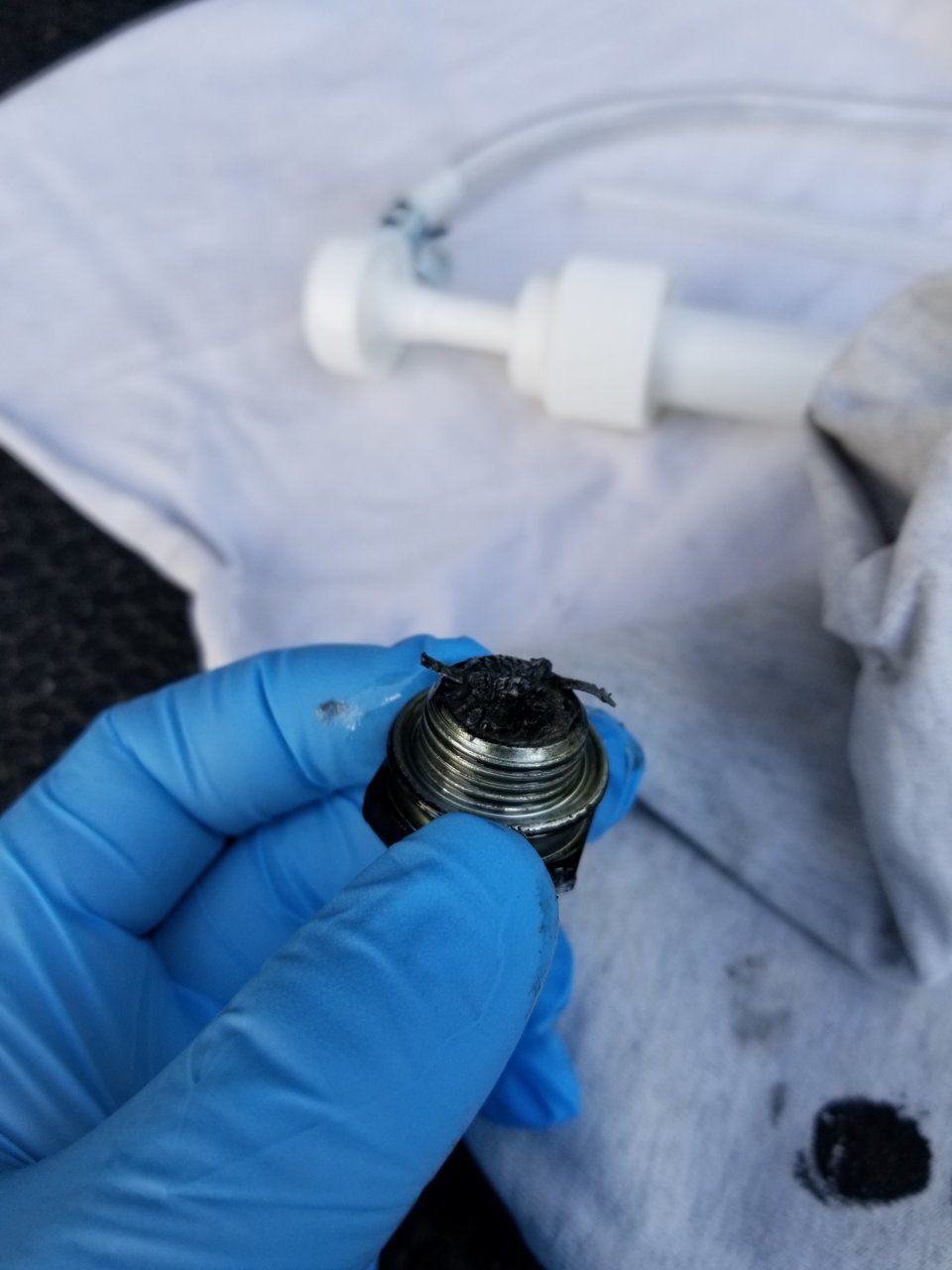

    Replaced the rear with valvoline synthetic 75w90 and found some decent shavings. Didn't think of it while I was buying the oil :facepalm:but do I need to replace the front diff with 75w90 so both diffs are the same viscosity? Was going to wait awhile as I haven't used 4x4 much.

    Yes. Same weight but only 1.6qt needed up front. It looked almost as bad as the rear diff. I get some wheeling or the 10mi on straight roads per month. But considering the ADD, the diff gears are whirring around in there, just the ring and pinion aren't.

    Is that long strip of debris in the sludge metal?!

    Yep, there were a couple of 1/4 in ones. I'm guessing its from the break in period?
    Edit: the pic shows 2 seperate strips of metal back to back.

    Probably. It just seems like a big chunk to exist in the diff as is.
