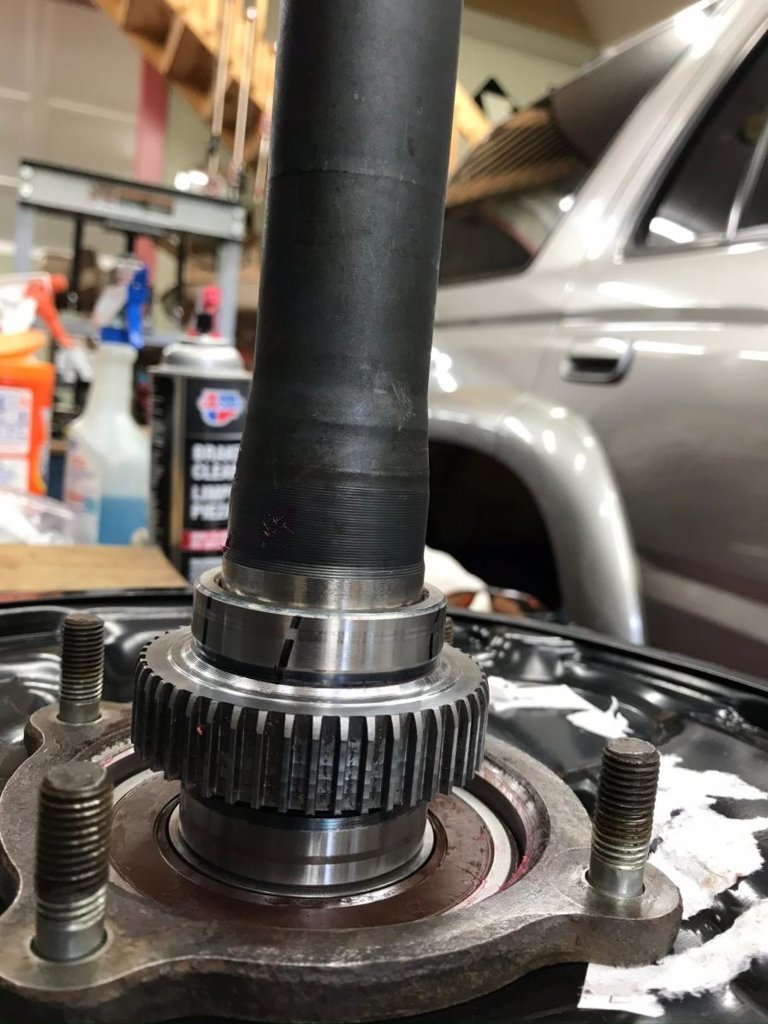

    I would grill the person doing the pressing pretty hard about their experience doing these bearings. I had a shop reassure me they would be right. Well they effe'd it up and the spacer was nowhere near close to the seal on BOTH axles. The sealing surface needs to be within a few millimeters of the seal center or it will leak. Even if your getting a shop to do it watch the video. I would bring a caliper with when you pick them up so you can measure the location of the retainer. Just my .02. I've been burned by almost every shop I go to lately. I ended up getting the tools and doing it myself.

    Watch the timmy toolman videos and you'll understand if you take this to a non toyota mech there's about a 50/50 chance they'll do it right
    the newer seal has to seat on that ring perfectly.....
    I reversed that ring as in his videos to maximize the seal area........it was a hard lesson learned by the 4-runners.
    if done by others....I'd still do the grease test as in the timmy vids to be sure
    without the grease test or marker test......you'll never know if its right
    if new one fails it'll happen well outside warranty.....15K to 20K

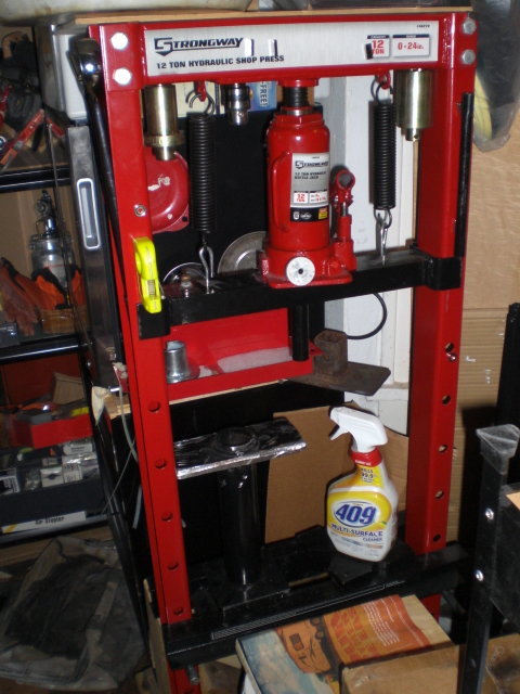

    considering this is $1000+ job......buying a $200 press and that $50 toyota axle tool is not a stretch
    I was able to use a $120 12ton one from Northern tools......after making a base to elevate it about 10"
    Although I doubt they're that cheap now.....
    What happens if the new seal does not match up perfectly with the dorman pre assembly
    we are only talking 2 or 3mm leeway
    IF you notice here they've got that ring reversed as in the timmy recommendations.....
    .....taper is outboard instead of 'in' --------------------------------------------------
    from the marks...
    If they hadnt done this.....the seal would have set right on the beginning edge of the taper
