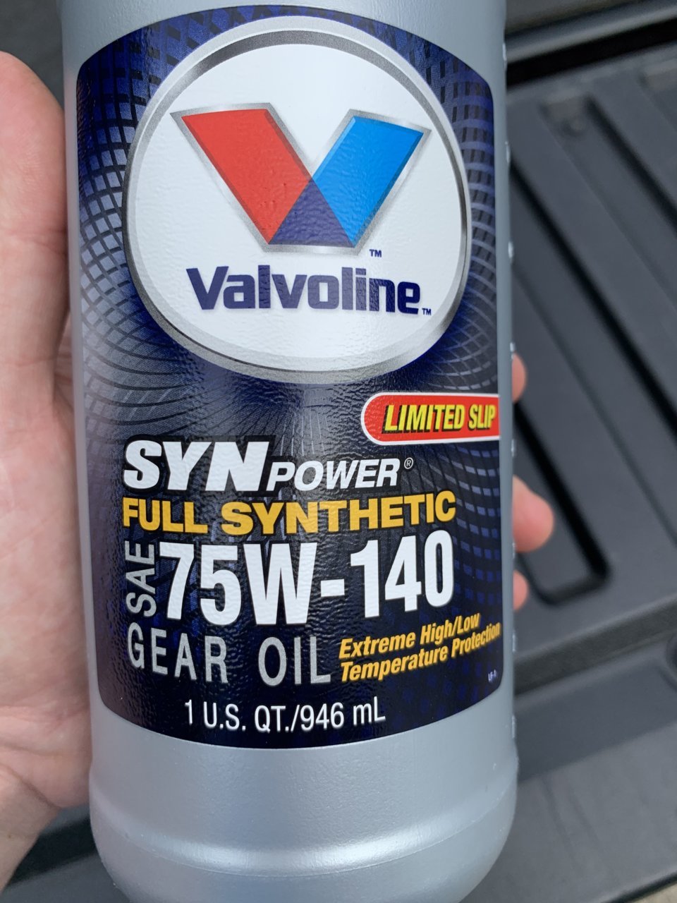

    Hey guys, I have a 2013 TRD Sport 4x4 4.0 ltr, and about to change out my rear diff fluid, as my trucks at about 63,000 km (BC Canada here) but checked my fluid at the fill hole, and some dribbled out nice and clear. I’ve had the truck 4 years, never changed it, and I’m the 2nd owner. Haul firewood in a trailer during the fall/winter/spring which is about 2-3k pounds I’m guesstimating. What do you think, leave it some time longer or change to a thicker fluid as I do haul some weight seasonally?
    Bought some Valvoline 75w-140 full synth with LS, cause I wasn’t sure what I had, then found out here on TW that the ‘09+ TRD Sports don’t need the additive. Thinking of returning it and getting Lucas 75w90 full synthetic or the 85w-140 like ECGS recommends, but then I only have a stock factory diff. In a bit if a quandary here...I like to baby my truck inside and out.
    Open for suggestions, thanks guys!

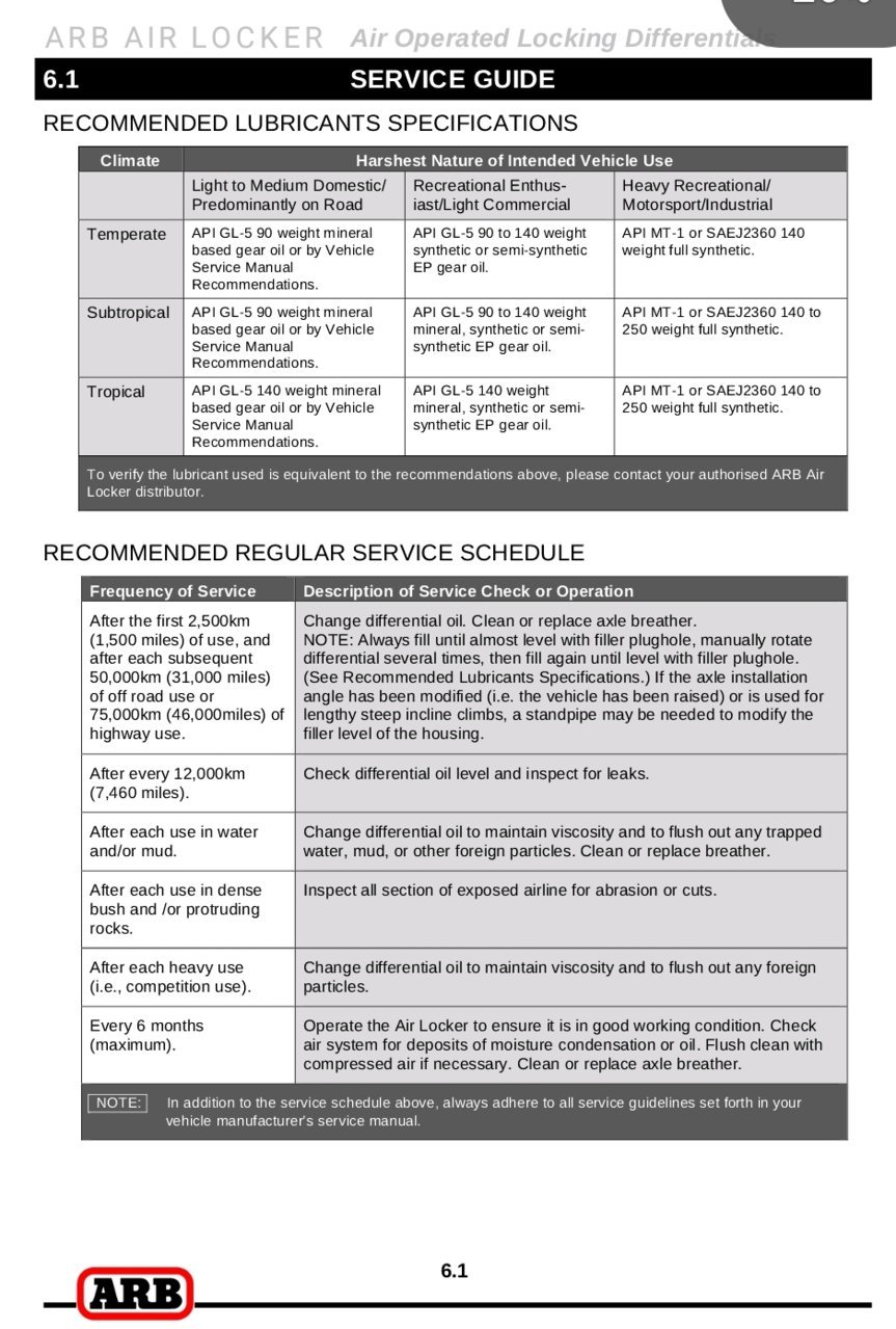

    What are you running if you have an ARB air locker?
  17. Aug 16, 2019 at 9:29 PM
    #37
    b_r_o
    b_r_o Gnar doggy
    Nov 17, 2016
    #202672
    14,873
    Alex
    WA
    2015 DCLB
    Looks like they recommend anything from 90w all the way up to 140 depending on temp and load
    Mully[QUOTED] likes this.
