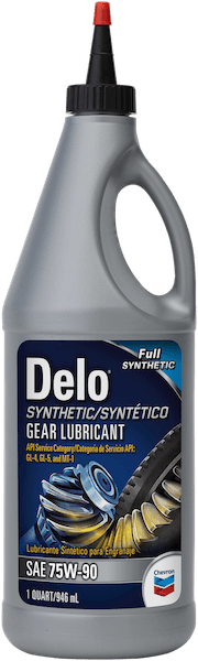

    DaveInDenver
    DaveInDenver Not Actually in Denver
    May 18, 2013
    #104390
    3,619
    David
    Grand Junction
    2008 Super White TRDOR AC 6MT
    Unexceptional
    I typically use 75W90 or 80W90 because the manual for my 2008 calls for 90 weight or 80W90. So it would seem having a viscosity of 90 is the consistent part of the specification and I dunno the significance of 75 vs 80.
    FWIW, the most recent change I went with the Chevron Delo Syn-Gear 75W90. It's full synthetic and was cheaper than Mobil1. Over the years I've used Castrol Hypoy-C and Redline 75W90.
    Honestly, the only lubricant that I always use is MT90 in the transmission otherwise it's kind of whatever meets the spec and I can find.
