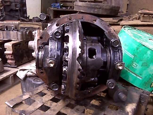

    Good job but I have bad news for you - read the rules of the board!!! If you break anything while you are a member, you have to
    Post Pictures of
    the FAILURE!!!

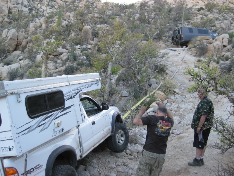

    Yah, like this can happen... On the road to Mision Santa Maria, Baja California ('03 Taco with a pop up camper):
    HB MURPHY was there, too!!!
