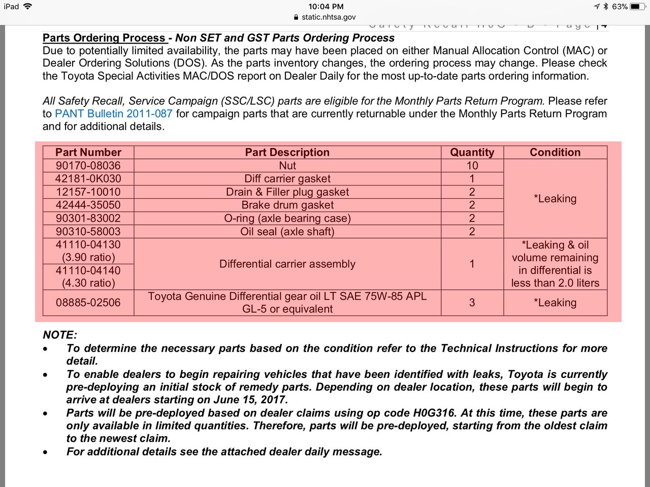

    354B2324-0141-4B0F-BC70-1C9C71480B7D.jpg My rear dif was 1 quart 8 ounces low from the factory when I checked and filled it myself at about 200 miles. It has no leaks and is making no noise.
    In looking at the parts list on page 4 of the recall notice it shows 3 liters of gear oil required.
    Is that recall just for non dif lock models?
    3 liters equals 3 quarts 5.4 ounces.
    Both dif lock model Tacomas listed in the manual require 3.8 or 4.0 liters of rear dif oil.
    The Tacoma manual on page 576 shows up to 4.2 quarts, or 4 quarts 6.4 ounces capacity with rear dif lock.
    Just asking. Are rear difs being serviced at dealers going to be filled properly when replaced? Or, is your fine Toyota technician just going to add 3 liters as listed in the notice and call it good at 1 quart short?
    Perhaps it would be good to check their work by checking it yourself after service is performed.

    In that safety recall doc. I interpreted it as: when the tech inspecs it for leak, finds a leak and measures the amount lost and the amount of oil left is less than 2.0L, they are to proceed by replacing the diff carrier.

    A0AE385E-5B5A-481E-8B1A-E3B23812823E.jpg Just a screen shot.

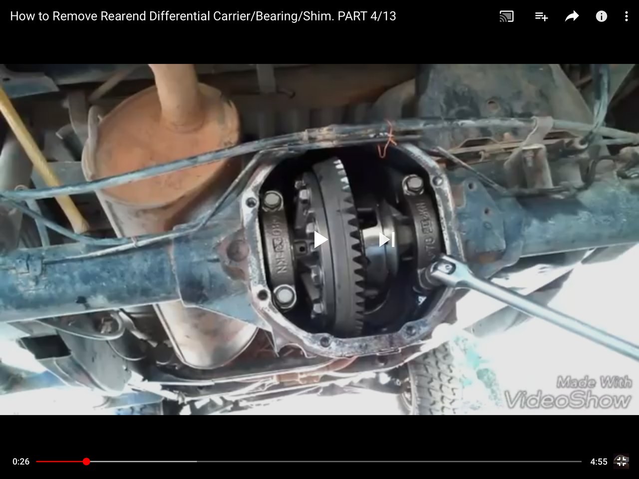

    If they replace the rear differential carrier, they need to remove the rear differential cover rendering the rear differential empty and visually in an open state.
    That’s why the parts list requires 10 new nuts and a new gasket. They are then also replacing some other gaskets and o-rings for the axle shaft.
    When refilling they would need more than 3 liters, unless they capture and re-use your old dirty gear oil.
    That wouldn’t be cool.

    It’s a third member so it does not have a diff cover.
    Skydvrr, fdbyrne and MoneyMan55 like this.
  18. Jan 12, 2018 at 11:20 AM
    #18
    fdbyrne
    fdbyrne Well-Known Member
    May 4, 2014
    #129114
    710
    Missouri
    2016 Tacoma TRD Off Road (Manual), 2004 4RUNNER V6 4x4
    These don't have differential covers. You have to remove the drive shaft, pull both axles out a few inches, then remove the entire 3rd member as an assembly to see any of the internals.
