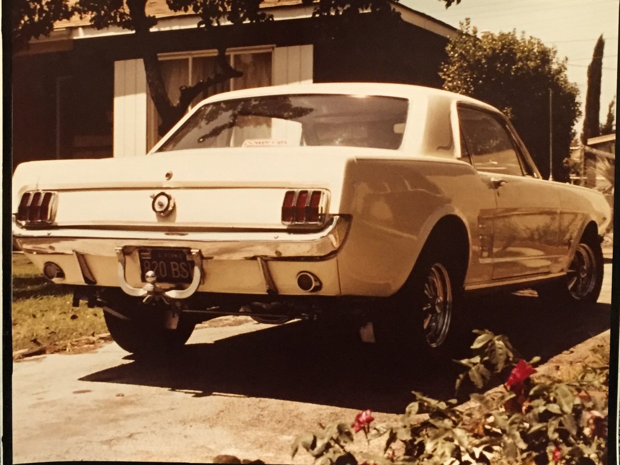

    OregontoBajaCA
    OregontoBajaCA 2025 DC OR High Bread
    Dec 6, 2017
    #237812
    849
    2025 OR DC iF Max
    For your entertainment! No rear dif cover. Circa 1978.DF6E77CD-018E-4B24-BCCF-B36AFB1C0AA3.jpg
    ANTupLIFE likes this.
