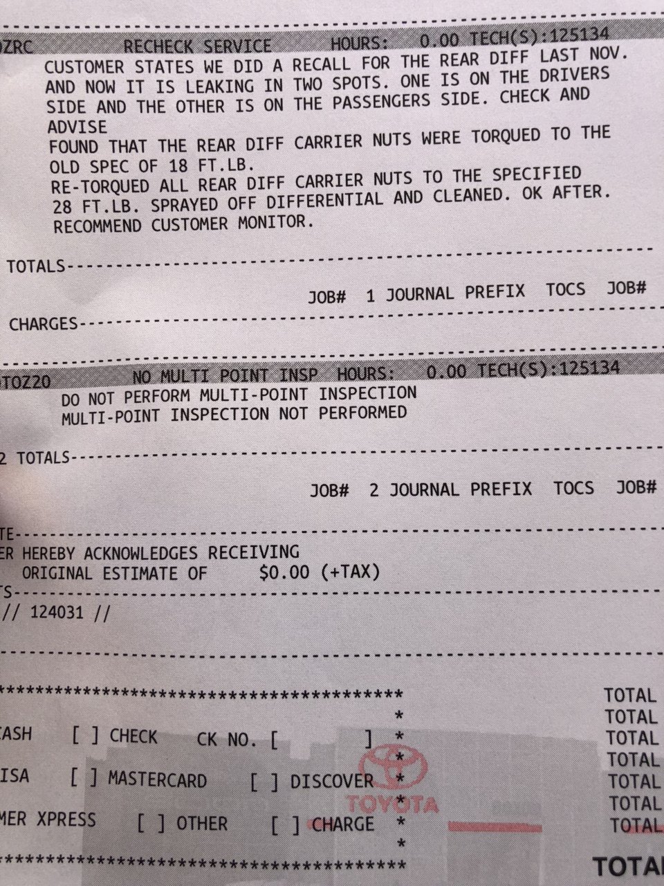

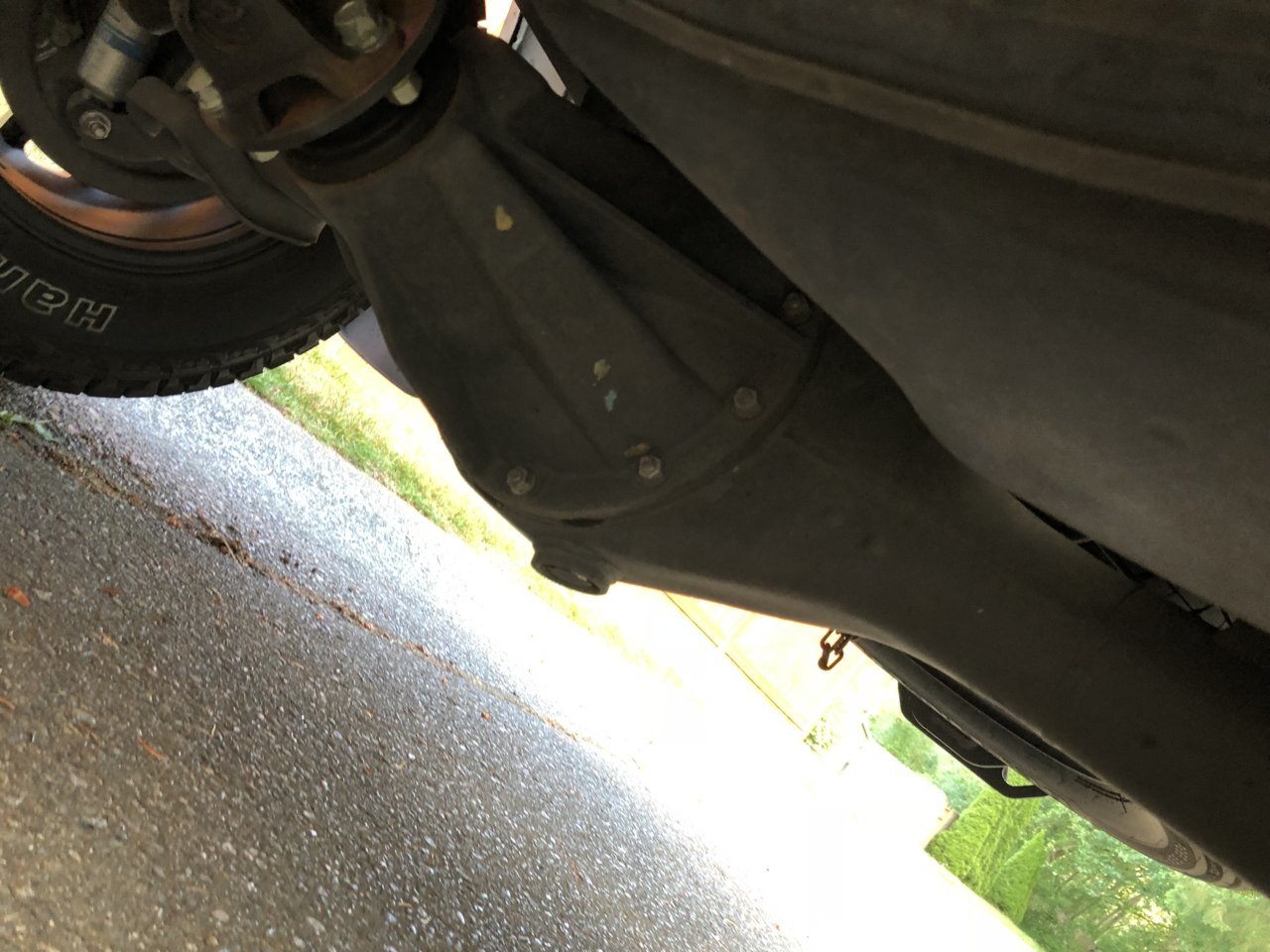

    Had this recall fixed 11/17, checked 2 days ago, it’s now leaking on both sides. Anyone else having similar issues?

    Looks pretty minor. Just slight weeping. Unless you are planning to go on a major road trip you could probably wait until your next scheduled service. Fortunately, although I am on the recall list for the diff leak, I have not had any leaks so far.

    If you mean fix as in they just re tightened the bolts down and sent you on your way then they never fixed it properly. It was bound to leak again.
    They should have replaced all gaskets and washers with new ones and refilled your diff fluid. That's the real fix.

    They did all of that, I have receipts showing all they’ve replaced. All that you mentioned was done

    Change out the diff breather to a two way like the ARB and relocate up into the bed or behind tail light.
    My theory is the stock breathers get stuck and pressurize the diffs pushing fluid past the gasket.

    All tight back there now

    I had the recall done under warranty TRD OR. Now at 54k it is indeed leaking in the exact spots as before along with 1 spot on the driver side and surprisingly on close inspection out of the pinion. Appointment made w/ rental.

    Seriously annoying. Makes me believe that the housing and or the carrier assembly machined face isn't flat. WTFK
