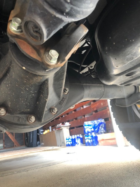

    Yesterday, I called the service department of my dealer. Service guy looked my truck up and it is not on a recall or TSB since it is an OR with the larger axles/diff. He said to bring it in anyway and he would check it out. I have an appointment today. We will see how it goes.

    My truck is currently at the dealer (Cobb County Toyota). The service guy (David) called saying it was ready for pickup. He also advised that there was nothing wrong with my differential. My differential was not wet or leaking but had the same stains on it as shown throughout this thread. Because my truck is an OR and the VIN isnt bringing up a recall or TSB there is nothing they can do with it. I spoke to David's boss Todd and he advised the same thing.
    Long story short is the dealer says there isn't an issue and wont work on it since Toyota says VIN is not affected.

    My vin was not on a list either but, it seeped in 3 places and now the front seal leaking. Keep those photos and your service ticket and get under and look every so often. If it gets worse, I’d be back with photos and prior documentation. I was not on the 3rd brake light leak list and the ac blower list either and all have failed.

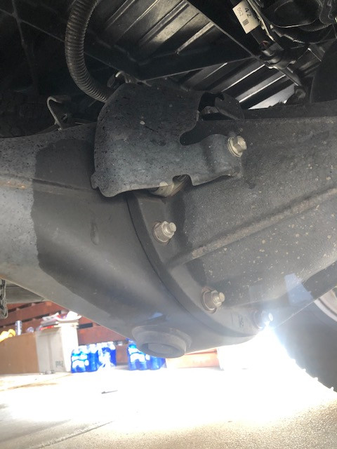

    Hey guys, sorry to bump an old thread. Just noticed some "seepage" from my rear diff. Seems like the consensus is to re torque.
    2017 25.5K miles
    Powertrain is 60K though right?

    Yeah, mines been weeping for a while. Had it replaced at around 25k, now at 37k... It's at it again... So bad it's across the whole rear axle.

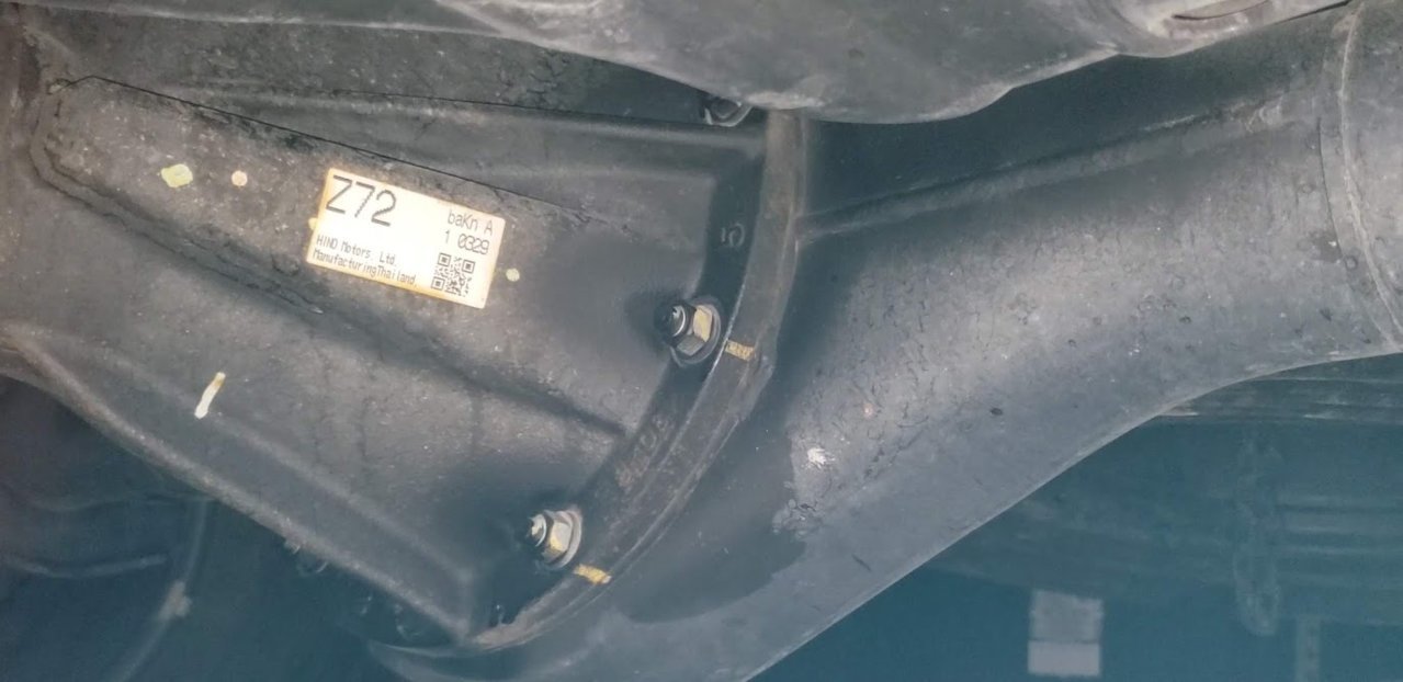

    Ouch, my 2019 Tacoma TRD Off-Road M/T is also seeping.
    I'm at about 28,000 miles and it's still bone stock even though I got parts on the shelves to re-do the suspension etc.
    Though perhaps to be safe I'm going to wait till I get this squared away.
    Maybe start by re-torqueing the bolts / cleaning it off and seeing if the issue persists.
    **Edit to add**
    It should be noted, there's literally no reason for a diff seal like that to seep.
    I've been under plenty of older vehicles that don't leak even the smallest bit.
    Is it true that this is a paper seal?! (need to look this up)
    I will likely re-do the breathers to be safe, after this is worked on, lest that somehow be playing into things.
    And while I could do this myself...I think I'll try and get it done under warranty to cover the cost of diff oil as that isn't super cheap. Also I got a warranty still, so may as well use it.

    Had same weeping like in pics above. I retorqued couple of different times and it helped for awhile but I couldn't stand it so I rebuilt my whole rear axle.....wheel bearings, both seals on each side, new diff gasket coated with red rtv on both sides, new gear oil, new wheel cylinders, new brake shoes and hardware and new drums.....only thing not replaced was pinion seal. Been dry ever since 2019. Yes, really thin paper gasket in there.
    Major difference from some mileage quotes above is that mine was over 150k miles and had had daily 80mph 35 mile hwy commuting for over 5 years. Not my dd and no hwy commuting to job any more so 3 years later still not over 200k yet.
