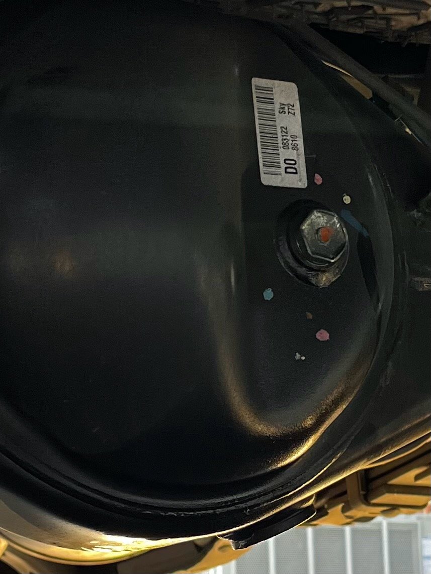

    Was under the truck to rotate the tires yesterday and noticed a small droplet of oil on the bottom of my pumpkin. After further inspection, it’s quite obvious that the diff is leaking from the drain plug. Nowhere else do I see leaking.
    This truck only has 23K and it’s all been road driving. No diff service. I have an appointment in a few days to get my drivers front strut replaced and my glitchy speedo needle looked at. I will definitely be adding this to the list.
    In the meantime, any ideas what I would be looking for? I’m going to inspect the breath valve when I get home. I am surprised at the issues I’ve run into on this new Tacoma.

    Toyota uses a crush washer for the diffs, although you may not have serviced it, the dealership may have serviced or changed fluids. Its a $3 crush washer and cannot be reused. Diff shouldnt be leaking from there anyway as thats the fill line and if its leaking out that means its overfilled. Take that out, replace the washer, ensure the fluid is good (color) and put the fill plug back in. Should be good to go otherwise. if the fluid is black or metallic, contact the dealer (at 23k miles) and notify them immediately and I would either change fluid and drive in (save the fluid for proof to dealership) or tow directly to dealership.

    Remove the fill plug and replace the seal.
    The differential bearings are splash lubed. Meaning, it’s like a hurricane in there at 70mph.
    Lube can get on the end of the plug and seal out.
    Really hard to tell the origination of the leak with that pic. Take it to the dealer if you need to

    That's the fill plug, not the drain plug. The drain plug is in the bottom right protected by the flange. It's pretty difficult to get a leak out of the fill plug unless it's really loose or the crush washer has failed and you've spent some time on an incline or you've submerged the diff and it's pressurized.
    It's pretty easy to pop the fill plug off and take a look but if it's going to the dealer for wrork anyways just ask them to look at it.

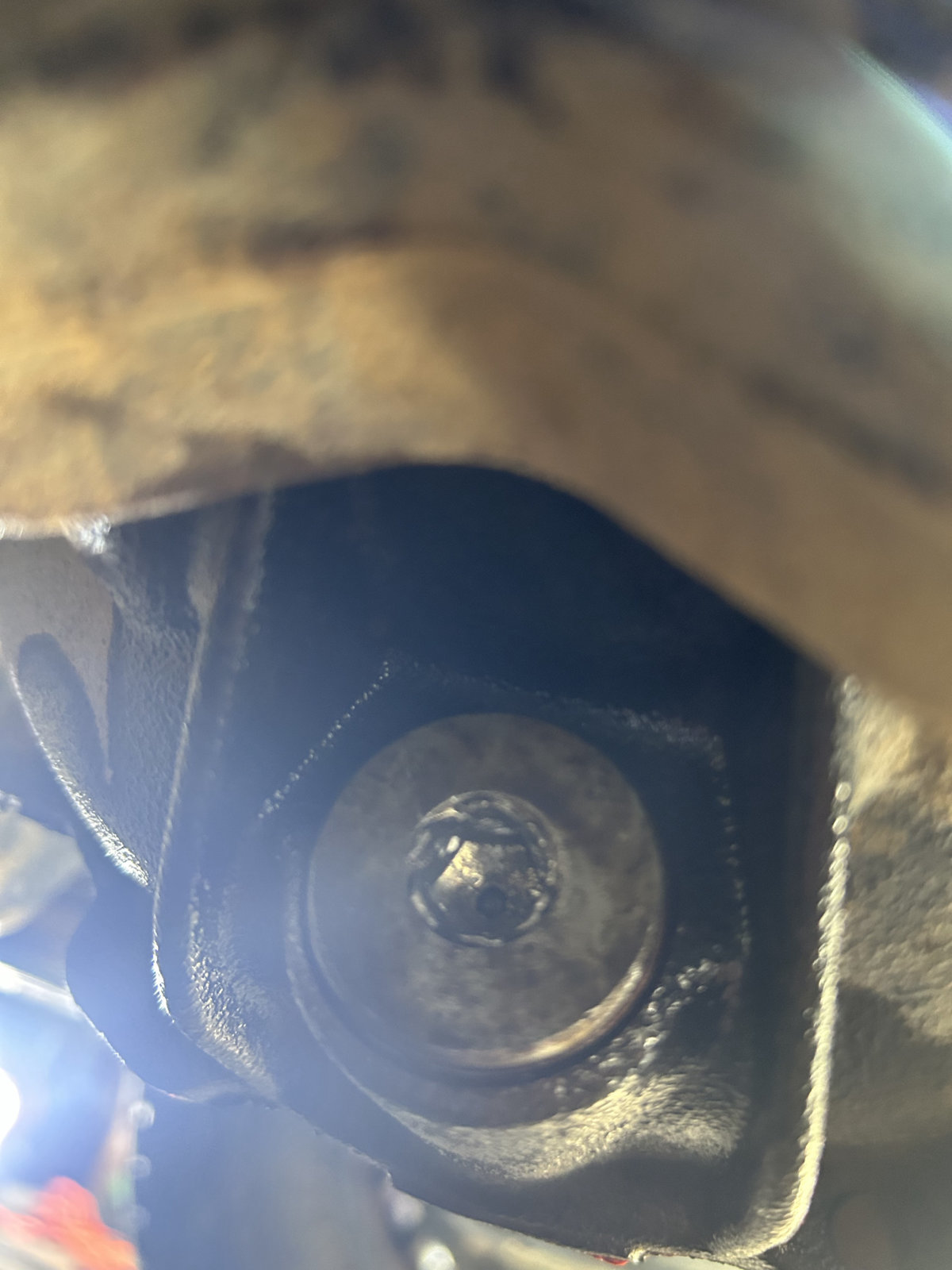

    I recently dropped the front skid plates to change out the rack and pinion and thought I should check the fluid in the front diff as well, this is what I found.

    Well I feel like a complete idiot. Here I am trusting Toyota so much I automatically ruled out a loose nut.
    I crawled under my truck tonight and the fill plug was so loose I could take it off with my fingers!!
    I took it off and stuck my finger in the diff. When I removed it, I had oil on it. Please let me know if there is a better way to check diff fluids. I believe the factory manual says to fill to just below the fill hole. That checked out with the finger test.
    Fortunately my drain plug was tight. I torqued my fill plug down with a few extra ugga duggas. It just blows my mind that it was that loose.
