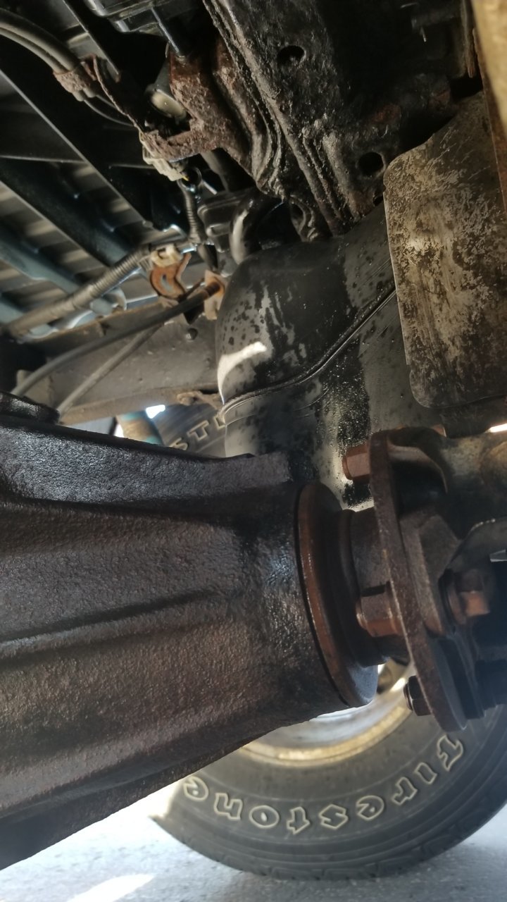

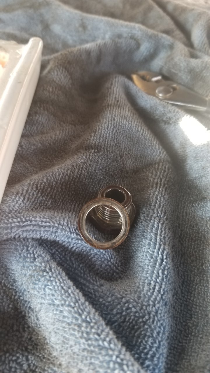

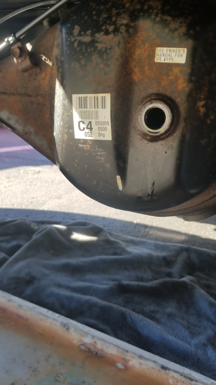

    Just a fluid drain refill
    Nothing came gushing out, heres the pics, how do you know if the washer is backwards or not?

    OP-
    when was the last diff fluid change prior to this one?
    why did you change the fluid, reg main? or something else?
    are you now or ever have experieced any strange sounds coming from the diff?
    have you thoughly cleaned the areas with gear oil residue with brake parts cleaner,
    then test drove to see that there is in fact a leak?
    it could be oil spill over from the fluid service you just had performed

    Just get a new crush washer. It was leaking.
    I guess it wasn't overfilled.
    SOMETHING made it splash out the overflow.....I don't know what.
    Does the oil stink to high heaven? It should if correct......unless you specified synthetic or the mechanic replaced with that.
    The fluid was low before though so we'll have to figure out now why.

    the drain washer is a crush tyoe
    needs to be replaced with new every time you drain it/remove it
    the upper fill washer is re usable

    there is no direction on those washers...either way works

    About 25k ago, when I bought the truck. So I tightened the fill plug and that's not leaking anymore. Yea the oil stinks. Toyota said to do it and wanted 700 to do my front struts so went with a cheaper guy and had him do all this other stuff to it while it was there. Definitely can hear a howl around 40/45 cant tell from the front or back tho.
    Still some splash of liquid from the other side of the differential. Pretty much straight line consistent to where the pinion seal is / I guess.
    Any quick fixes like sealant or sit on it til the dealer looks at it thursday ? Might try finding a reputable shop to look sooner.

    being the 2nd owner as you stated explains a lot now
    in the future (for troubleshooting assitance) always list those things in the initial post
    over the past 4 months I have become a self taught master of the gen2 taco rear end
    check out this thread-
    https://www.tacomaworld.com/threads/rear-end-howl-whine-at-60mph-no-more-howl-issue-solved.597315/
    after numerous tear downs & rebuilds of my rear end, I know this side of the taco pretty well
    a leaking pinion seal is the end result of some other failure
    something caused that seal to leak,
    & a fluid swap, or even overfill will not cause that (btw, you really cant overfill it, maybe a little but not much)
    you have a damaged diff my friend, likely need service or replacement
    to replace that seal you need to tear apart the whole rear end--->
    rear brakes, driveshaft drop, carrier assembly removal/axle spline removal....sort of a PITA, but doable
    if you are hearing strange noise from the truck at high way speed....thats tell tale diff failure sign
    dealer is $1600
    ECGS IS $700-800 with core
    you can likely get it rebuilt locally to you for $400-600
    this is a common issue on our trucks
    so dont worry too much
    we are here to help
    this may help you isolate the source of the problem & at this point your leak-
    https://www.knowyourparts.com/technical-resources/drive-train/diagnosing-differential-noise/
    the noise you are hearing is the key to the root of the problem
    try & figure when the noise occurs...accel, decel, all the time, slow speed, high speed, etc

    Since your saying the splash is above pinion and not overflow and fluid was low before, I imagine this DOES mean pinion seal.

    Vent plugged, diff overfilled, or both.

    I think if the pinion seal was bad you would see oil in a complete radius around the pinion. In other words everything in line with the pinion would have oil on it. You would probably also see it dripping from the bottom when parked. There would be an oil spot where you park.

    check you pinion bearing for play
    grab the driveshaft & move it up/down/left/right where it meets the diff flange plate
    a worn pinion bearing/race howls & if not addressed, can & will damage the pinion oil seal eventually

    the sad things is even if nothing internally is wrong with the diff, you still have to remove a butt load of hardware to replace that seal
