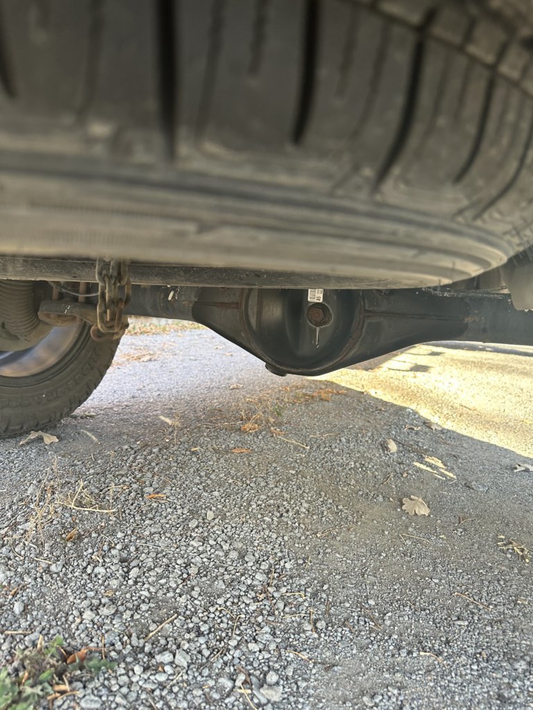

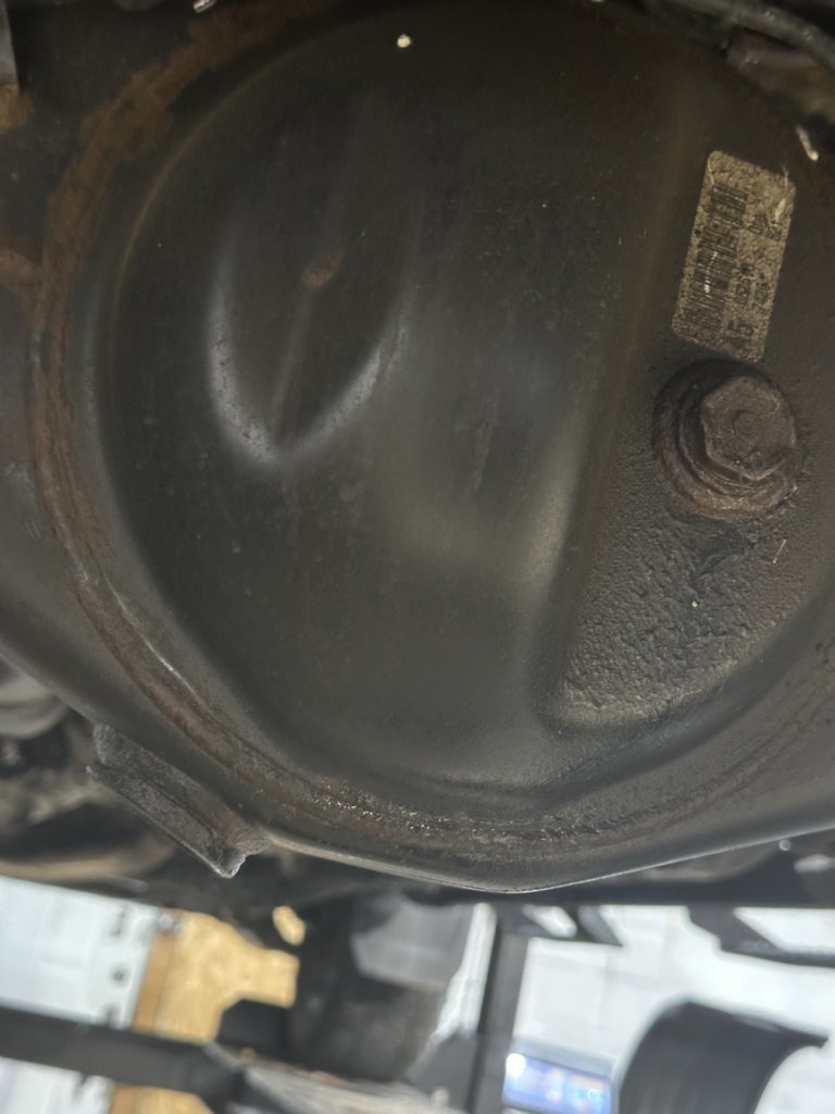

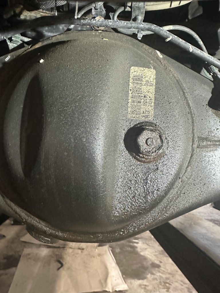

    Sorry i'm not mechanical inclined person so here's my noob question is my rear diff leaking on fill plug or on the drain plug?

    The fill plug would be my guess, but there would a lot of venturi effect going on back there.
    The easiest thing might be to hit the whole thing with brake cleaner then have another look after a day or two of driving.

    Way above the fill plug, check the breather.

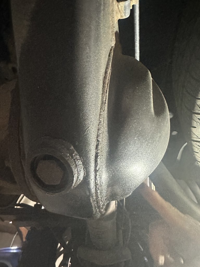

    What does the driveshaft side look. Fluid could be leaking past the pinion seal and being pushed backwards as it warms up while driving. I'd be surprised if it's the fill plug.
    Maybe start with completely degreasing it and check daily where it could be getting past.

    The drivershaft side is clean

    It's the fill plug
