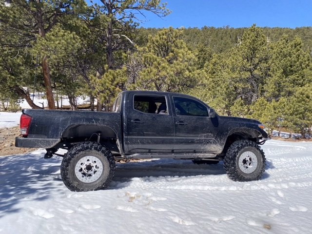

    Ok so I finally did some trail testing yesterday. I kept the locker engaged for about 15 minutes going up a rutted out snowy/muddy section of ironclads. It worked just like it did with the factory wiring. I also tested the wiring and it’s running at around 8V when engaged. So far no issues 9E781BE1-0A7C-46D6-AFB3-0A63BC933052.jpg

    Were you in 2WD or 4HI? I'd really like to use the locker without having to go to 4Lo all the time!

    If it works in 2 lo, there is no reason it couldn't work in 4 hi/2hi.
