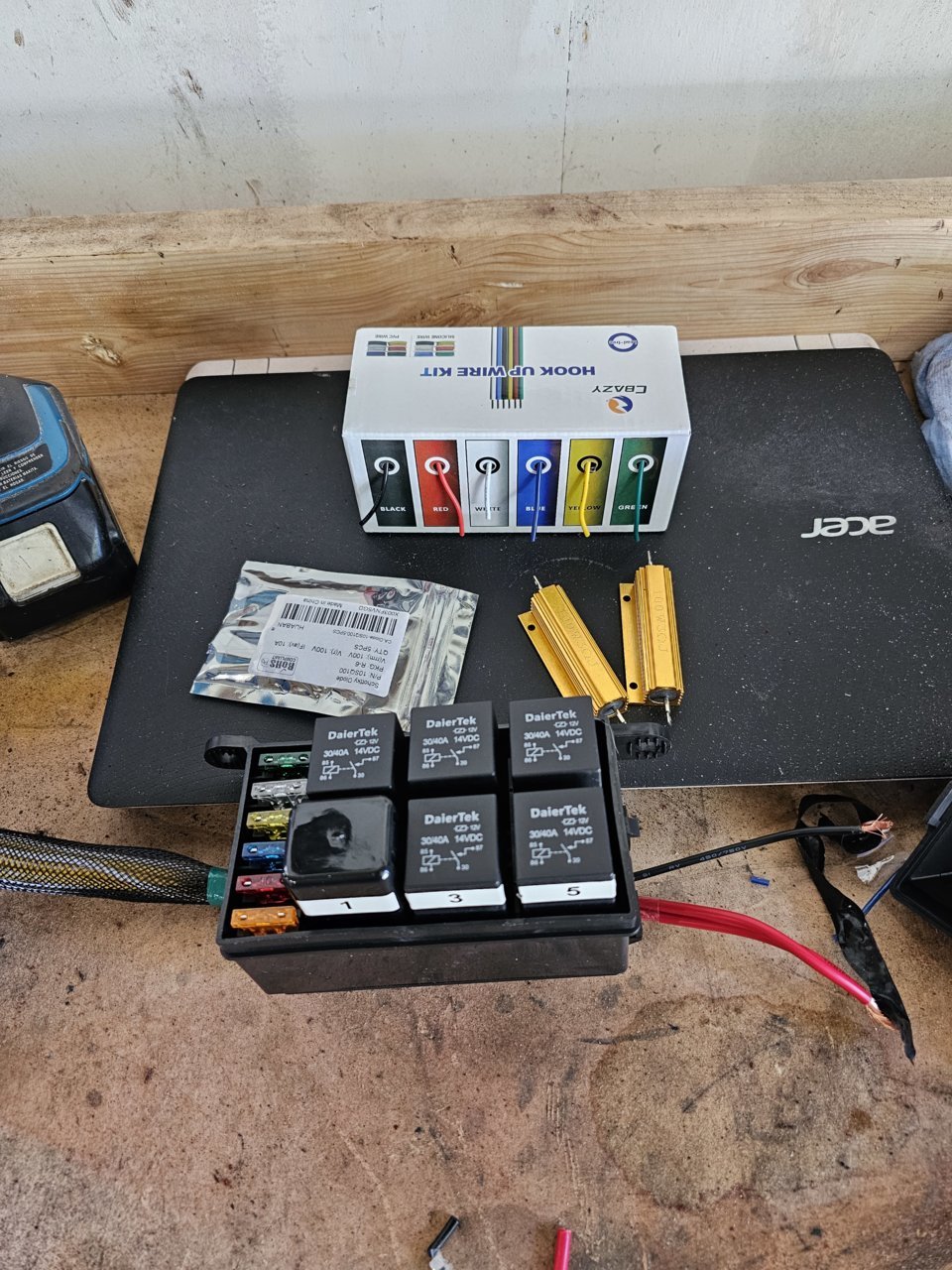

    doing things. waiting on switch and another resistor.
