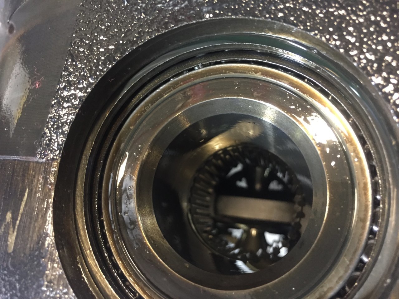

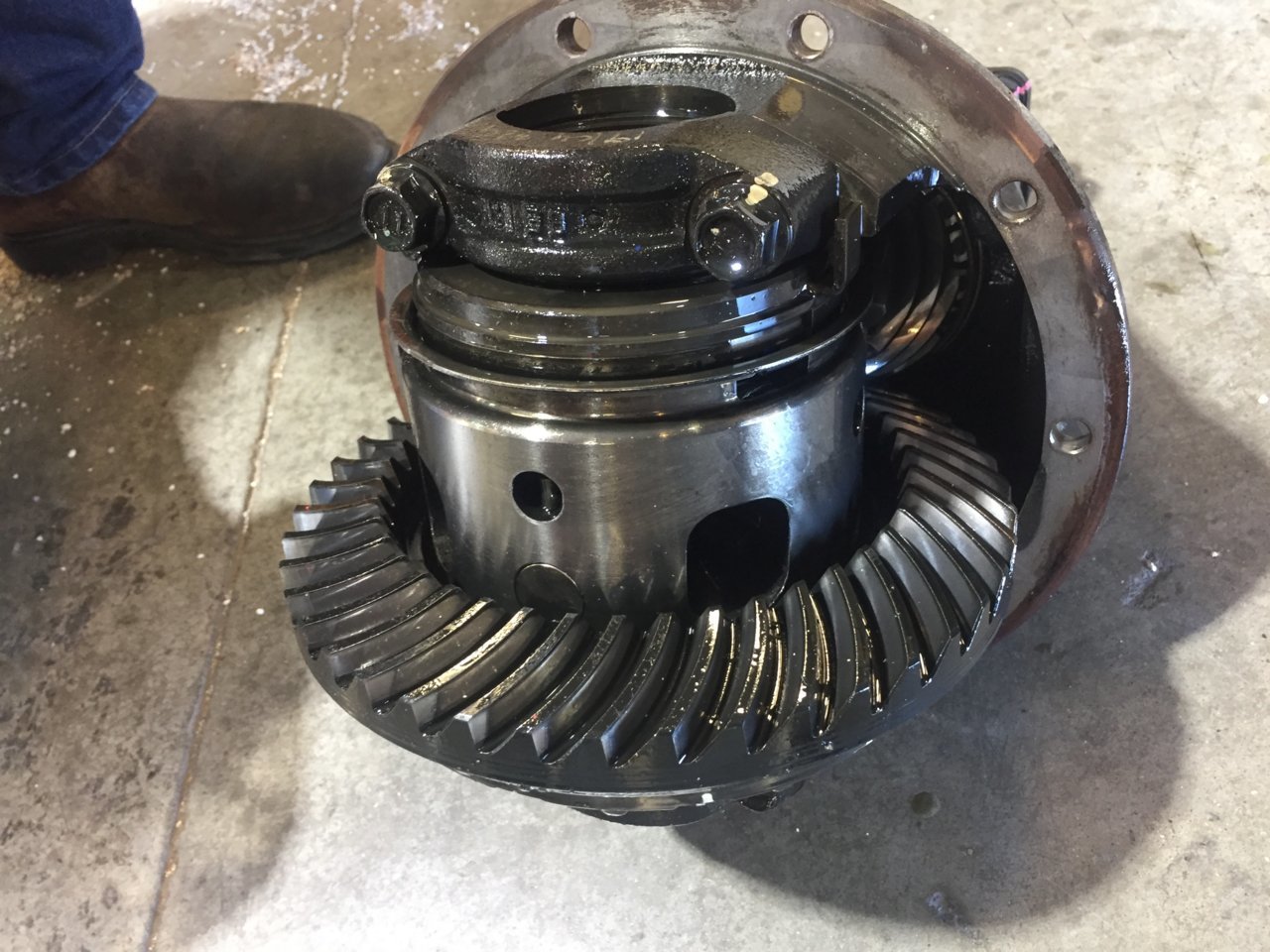

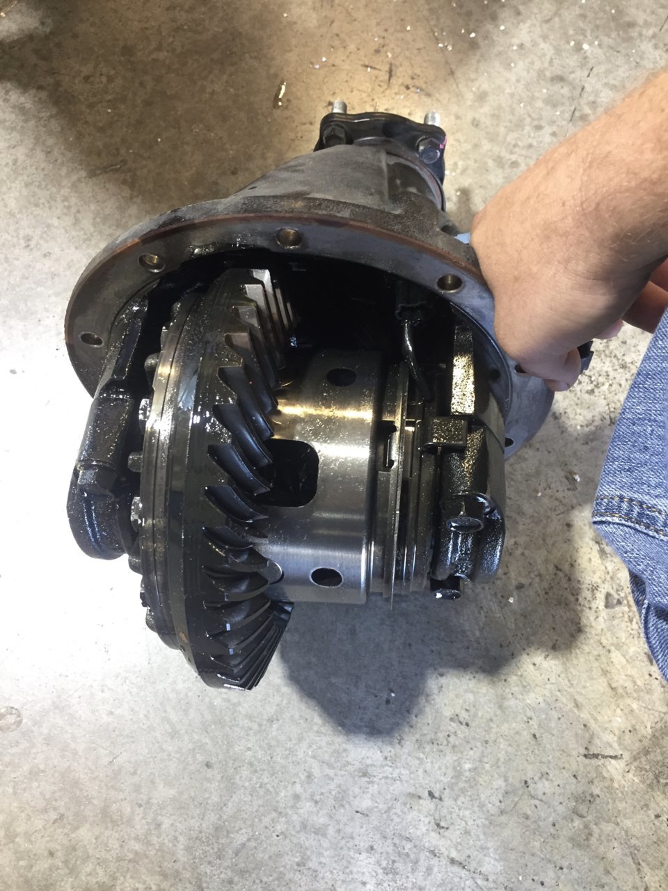

    No real help but I do have actually photos of the 8.75” TRD (Harrop/Eaton) elocker if any one wants to have a look. 4.30:1 ratio out of 6MT 2016 OR for reference. These are shots of mine that was swapped out under warranty for the howling issue.
    You can see the coil anti rotation tabs on the outside of the carrier caps and the wiring harness connecting to the coil. The press formed sheet metal ring is there to actuate the switch that turns the indicator lamp on. These lockers are spring loaded to be a normally open differentials. When locked the ring is moved toward the center of the carrier pulling the plunger for the indicator switch. This closes the circuit and lets the 4wd ecm know to turn on the light on the dash. These production units do not seem to be built as robust as the aftermarket units most likely to reduce cost.
    I figure a person could order a harness for a Harrop Elocker and wire it in in parallel to the factory wiring with an additional switch to stop the power from back feeding into the factory wiring and achieve the results most of us are seeking.
    Due to the duty cycle on the coil you will however have to be careful if you engage the rear locker. I believe it was said earlier that the coil in this locker has a 70% duty cycle or 7 minutes out of 10. That said you could potentially damage the locker if left engaged for more than that 7 minutes. We may be able to find a higher duty cycle coil to retrofit into our lockers to alleviate this issue.
