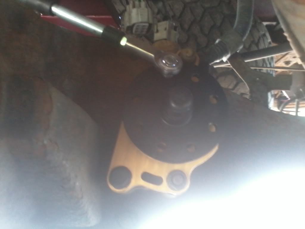

    yeaaa i just took my locker off, disconnected my breather and nothing but a shit load of dirty water came out i guess this is why when i press the button the gear doesnt spin

    01 trd 4X4 ex cab manual
    Gray wire, Some lights in the bed area, and some character marks throughout.
    Always works.
    970btu likes this.

    ^ What is that?

    Pretty slick! My locker is currently not working and I was going to try and rebuild it. If that doesn't work, that cable actuator may be in my future! Kind of like the OX lockers...
