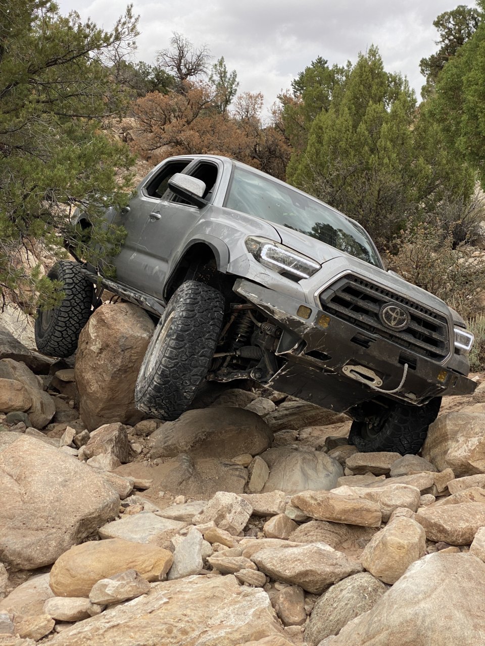

  6. Dec 16, 2022 at 6:44 PM
    ShimStack
    ShimStack Well-Known Member
    Mar 11, 2012
    #74701
    1,652
    Ben
    NC
    '91 Truggy, '98 Project, '16 DC OR M/T Locked F/R

  10. Dec 16, 2022 at 9:48 PM
    Mike402
    Mike402 Well-Known Member
    Mar 13, 2020
    #322067
    1,073
    Palm Springs, CA
    2020 Custom TRD Off Road
    Now that is putting your sliders to good use.
