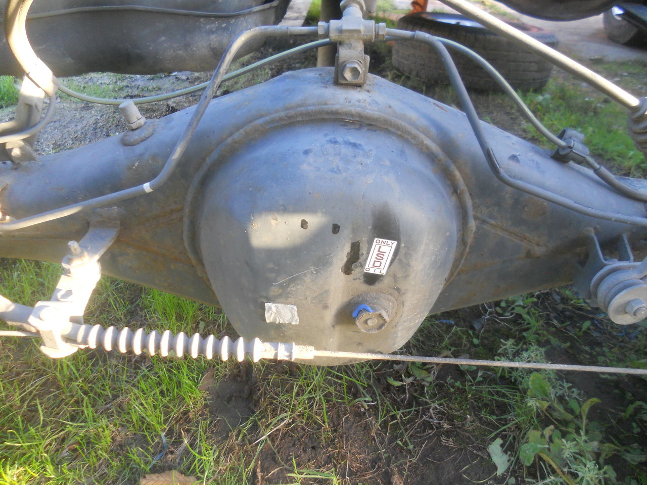

    DSCN7106.jpg Most Toyotas that require LSD oil will have a white sticker on the rear end by the fill spout. If you have a E-locker you do not need LSD oil.
