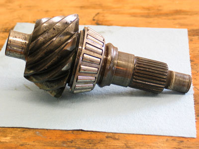

    Here is a picture of what I'm talking about.
    Dual opposed tapered rollers standard and then the pinion support bearing.
