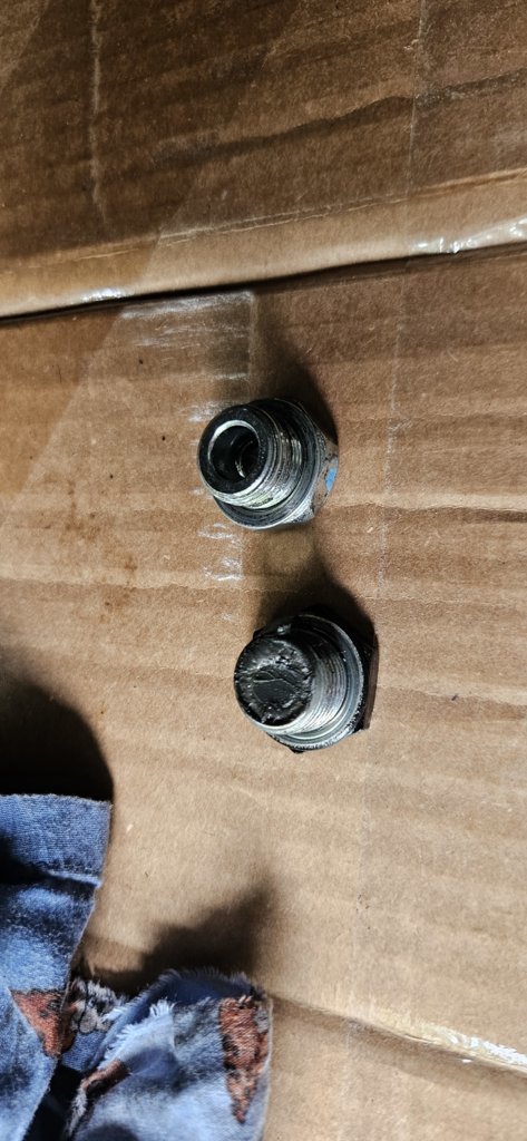

    I changed mine right around 30k mi and here's what my rear drain magnet looked like. There is some sludge but that's very normal. Dealers tell you to replace a lot of stuff unnecessarily so definitely find someone more qualified than the parts swap department and have them show you what the magnet looked like. If they conveniently forgot to take a picture, fill it and keep driving.
    Mine whines as basically everyone else's whether they admit it or not. Has gotten louder around 10k mi and stayed the same since. Good luck and hope it's nothing.
