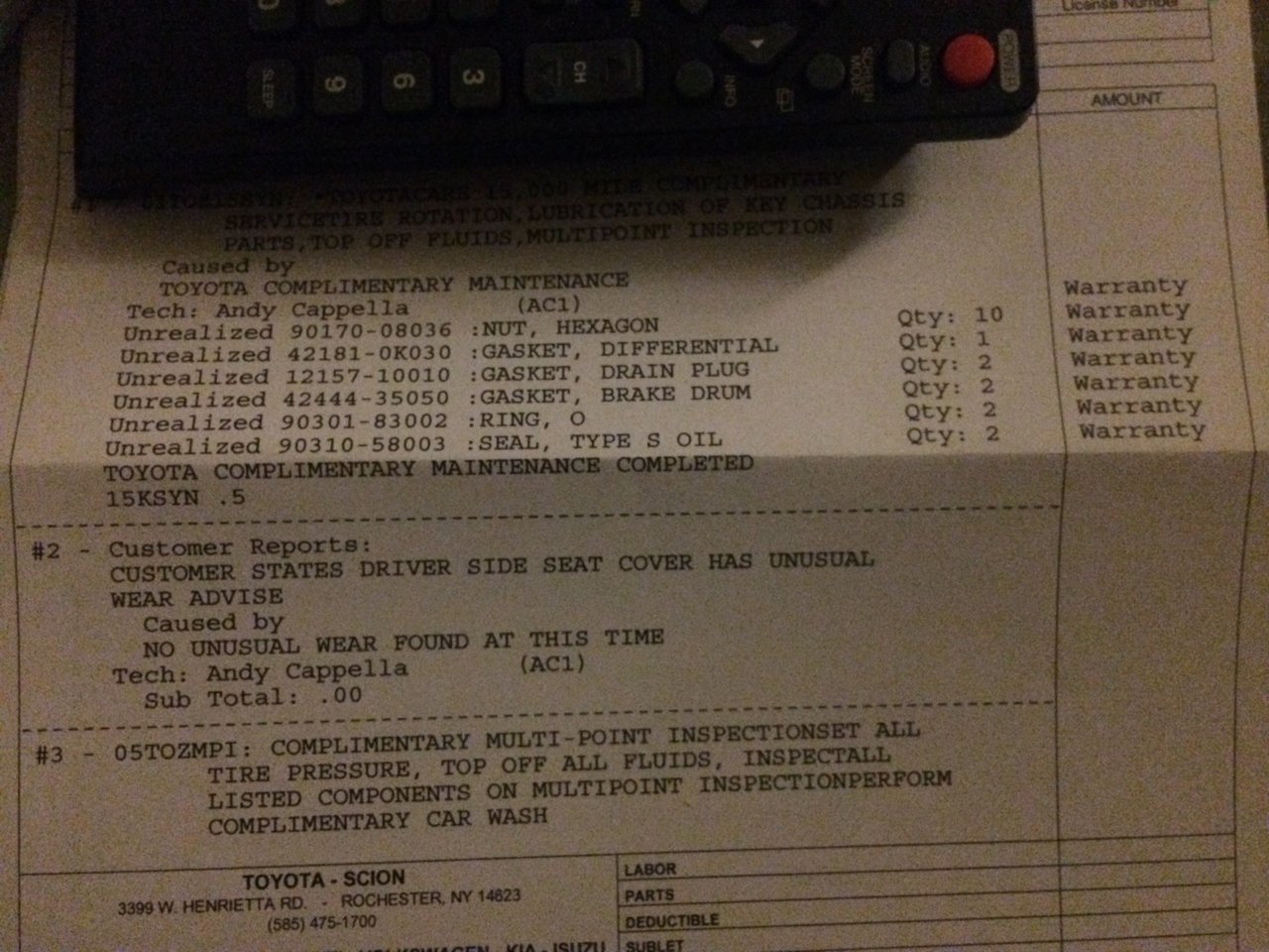

    Here is what they changed on mine back in October, I believe one of these these things is axle seals hahaha.IMG_0459.jpgMine was not on the recall list, (SR 5MT) so it was all done under warranty.

    Yes, parts 90310-580003 are the axle seals...

    It is just the gaskets and nuts that are replaced--the OEM studs remain--leading me to believe the studs are not at issue; just not torqued properly at assembly

    The issue is the cheap gaskets that they used not the studs or being torqued properly. Even when they torque them down properly, they still come back leaking. Ive already been through this process.
