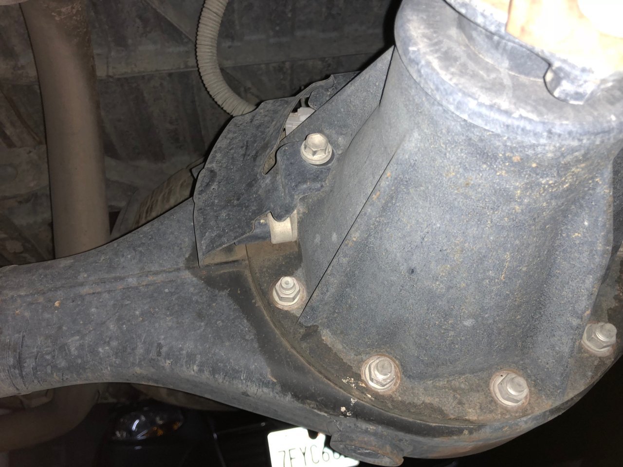

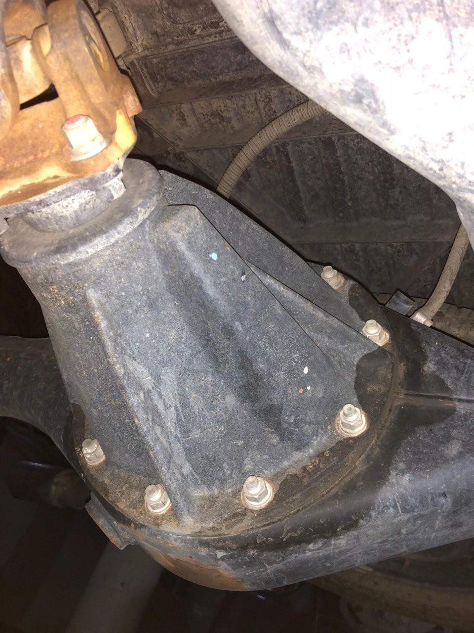

    Well, my truck isn't on ANY recall and I've had to fight for any TSB... Replaced my own failing CKP... And this morning I see this. Was planning a 500 mile round trip weekend including some OR but I'm thinking it would be unwise to drive it that far w/o getting it into the dealer.
    Am I overreacting? Just drive it and get it in on Monday? I know it's my truck (and life) but how severe does this look to folks?

    I'd go have a good time. As long as it's not dripping, I would go. Just me.

    mine is seaping too... u'll be fine just take it in when you get free time.

    You are extremely over reacting. Mine has looked like that forever.

    Is it leaking from your dif breather mod? Looks like its comming down from the top- thats what the dealer might say...

    Yours doesnt look like it is leaking from the top like his.
    I think others are right, go on your trip and do the warranty work when you return. Be sure to ask for a new gasket, its shot. Dont let them just retighten the bolts.

    Just check the oil level prior to leaving and then go enjoy your trip.

    Some people have had success retorquing to factory specs. Also mayne buy the 8$ seal kit on Amazon try it and if not then go in. Doesnt look too concerning have fun

    I used Gasket Sealant, both sides, when I replaced the paper gasket after I added a LSD- torqued to spec and not a drop after 9 months.
