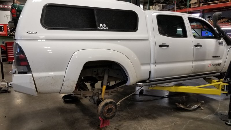

    Thought I'd follow up on this. My rear pinion seal leaked causing the stink. Gear oil is bad stuff.
    However, here we are in April and i finally got someone to open my diff and find out why it has been making noise for a while (like the entire time I've had it regeared).
    As you can see three was a reason. Theory is the pinion bearing failed (possibly installer error) which cascaded into other issues. Pinion gear moving and hitting the carrier. Pinion seal failure. Metal shavings in the diff. Small chip on one tooth on the ring gear. Fluid coming out of air locker air line.
    So, if your diff makes noise and smells... don't take "it's probably fine" as an answer from local shops.
    Total rebuild to occur on Thursday.

    Thankfully the parts supplier and shop are both stepping up to take care of me. So aside from inconvenience, the pinion seal repair i paid for in December, and now having to borrow a company truck so mine can sit... at least I'm not footing the bill for new gears, seals, and rebuild.
    Probably looking at a grand in labor and $400-$500 In parts. All because someone didn't get the preload right the first time.

    Dropped by the shop on my way home to get something from my truck. Even though parts won't be here until locker Wednesday afternoon they went ahead and took advantage of my dropping off the truck two days early.
    Third member, driveshaft, and rear axle removed and waiting for parts. If parts show up early enough on Wednesday they will get to work right away.
