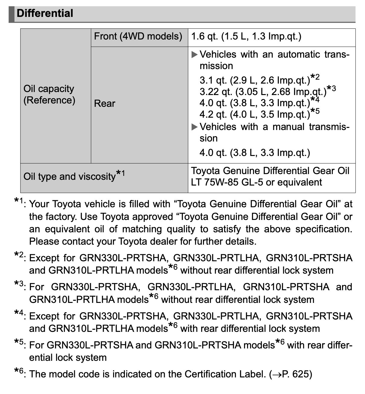

    it does but none of them have a quantity above 4.2 quarts.

    Right...I was referring to the statement that it should take "3.5ish" quarts.
    ORs (OP truck) and Pros have the larger ring gear rear diffs, which in my experience is about ~4.5 quarts.

    They technically aren't filled to the fill hole. They come from the factory slightly below, which is the specified 4.2 quarts. Filling to the fill hole is good too.
