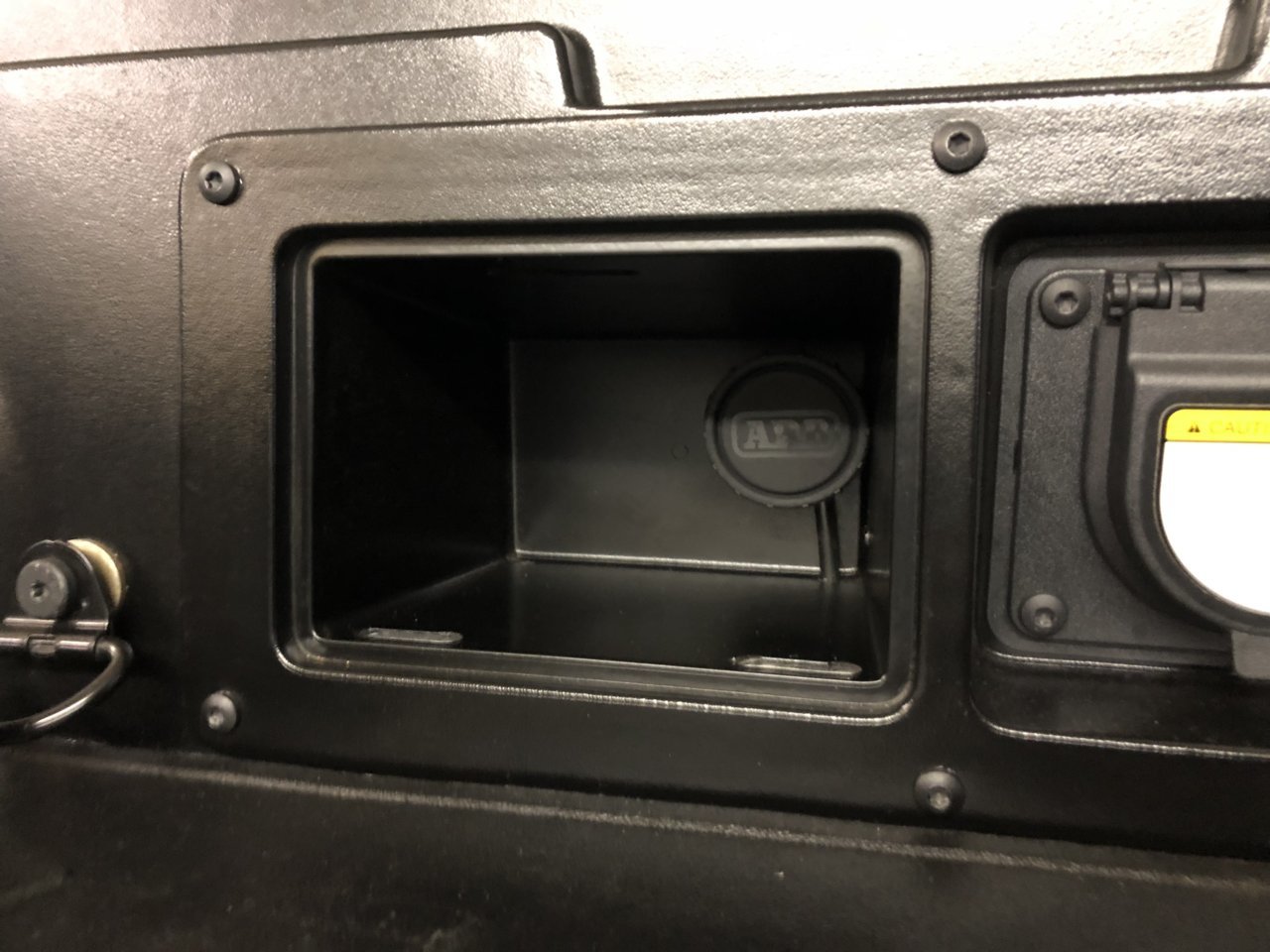

    There’s a couple write ups already. It’s a 5-10 minute mod, very easy. I ran it into the right side storage in the bed. There’s already drain holes in the compartment you can run the line through.
