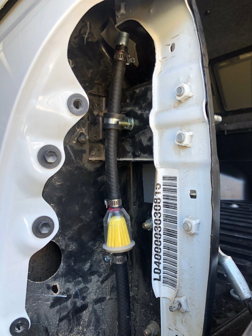

    I ordered the necessary parts and they came in. I will do this mod today or tomorrow. I have an extra in line fuel filter lying around that I might use as well to capture dust particles. I will attach the in-line fuel filter below the breather. Won't hurt I suppose since it acts like a filter.

    Finished the install. Took a hose clamp and bolted the 5/16" hose to an existing hole, no drilling involved. I even had an extra inline fuel filter laying around. So why not use it? The fuel filter will trap any dust getting inside the line. In theory the fuel filter can act like a breather on its own, but I installed both as water would go in the toyota breather slower than the filter.
    In a year or so I will unbolt the rear taillight and see if the filter element is clean or dirty on the fuel filter.

    Its a breather vent for the diff. The amount of air going back in is so small.. but I guess if that filter didn't cost you anything extra..

    Yes I know. Would be a good experiment and check the filter in 1 year and see if its dirty or clean.
