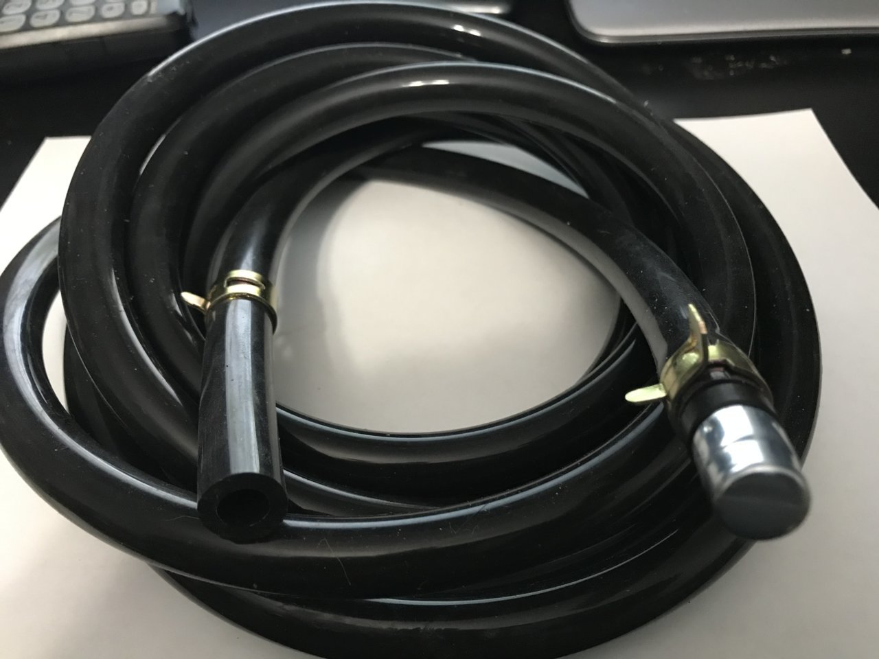

    All ready to relocate the rear diff vent.. doing ever thing the same but decided on a different type of hose.
    instead of fuel line i am using 5/16 ID heavy wall silicone vacuum tubing. Should be just as durable as the fuel line but much more flexible.
    And I have switched to using the spring style band clamps on everything..

    my reason for relocating isn't actually the concern for water.. I just want to eliminate the possibility of the original one way vent failing thus eliminating a maintenance issue. have seen several videos of pressure buildup being the cause of blown axle seals and lube soaked rear brakes.
    And yes, the fact that i like to mod things may be part of it :canada:

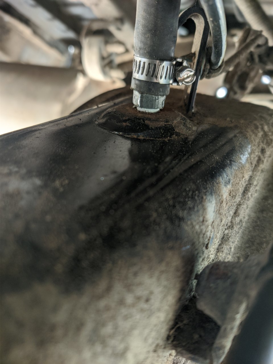

    Is this threaded in enough? It felt like I was at the point of stripping/breaking it. It felt like more power to put it on than take it off
  15. Sep 10, 2021 at 3:42 PM
    #215
    uncleART
    uncleART [OP] Well-Known Member
    May 12, 2013
    #103994
    1,489
    Arty
    Bothell, WA
    13 MGM DCLB Sport
    3" Toytec ULK 285/75-16 BFG KO2 Verge FN Wheels DeBadged, Toyota Bedmat, Window tint 30%, DeFlapped the front, Bilstein 5100s, Toytec coil overs, Dakar leafs, LR UCAs, SwayBar relocate, TRD Offroad tow hook, RotoPax, DeFlapped the rear, Tailgate mod, CBI receiver shackle w/ Bolt Hitch Pin, BFG KO2 285/75-16, FNWheels Verge, Weathertech Floor Liners, Spare tire mod, UWS toolbox with Bolt Latch Retrofit, Rear Diff vent relocated, Blacked-out grill emblem, Toolbox Bedrail mod, Trailer Plug relocated, ECGS bushing, Redline Hood Struts, Leer 100XR, C4 Fabrication Lo-Pro Bumper, Relentless Fab Frame Reinforcements, Warn 9.5XP-S Winch, Baja Designs S8 20" Lighbar, Off-Grid Engineering Dual Battery Tray, Odessey 35-PC1400 Batteries, BlueSea ML-ACR
    It looks good! Doesn’t need to be very tight; it’s just a vent.
