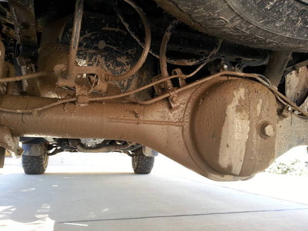

    1/4 -20 existing hole!!!??? Should be metric M6 x 1.25 I believe.....

    The hole is bigger than 1/4" and not threaded. Its just a hole stamped in the sheet metal.
    But it doesn't matter. Use what you have - its only fuel line.
    1/4-20 bolt with a nyloc nut works well and most people have that stuff laying around.

    ohhh okay thanks! i was going to be looking for a threaded hole. haha

    You got it Bret! Sorry about having a poor picture of this in the OP. it's hard to see.

    Unclear from the photo...where does the vent line enter the tail light recess? I guess if I look under there it might be obvious...

    It will be obvious. As you look underneath, you'll run it through the hole that the harness goes thru.

    All done....pretty easy. Biggest pain was the fact that my fuel line came off a really tight spool so it was a pain trying to keep it straightened out. I didn't run it through the brake line bracket on the axle either, just let it droop down from the frame to the union. Thanks again for the idea...definitely like this better than the gas door option.

    Good job! Yeah my fuel line was the end of the spool as well; so it was all twisted up. Tie wraps took care of it.
