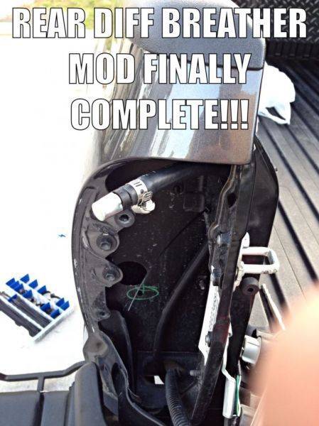

  18. Aug 4, 2014 at 1:46 PM

  19. Aug 4, 2014 at 1:49 PM
