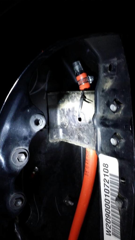

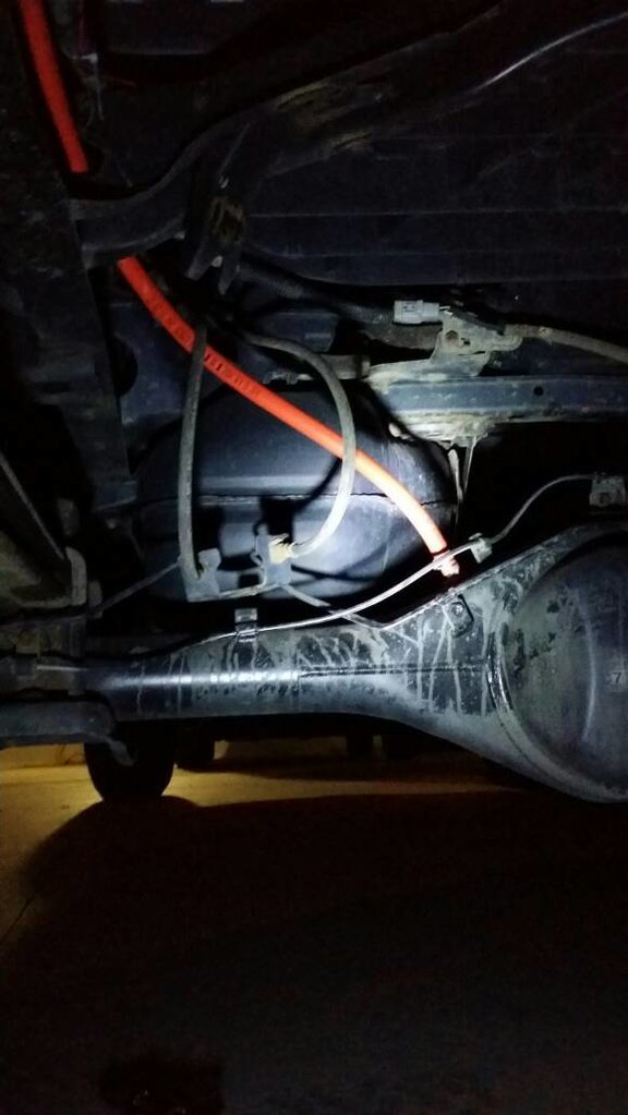

    Finally did this mod. Been meaning to for a while. It finally cooled off enough right before it went dark that I could do it real quick. Seriously took all of five minutes. 1889abdc14e280fb973d82960020ddef_bf9cfdc565e99905de519636bca45c8faa2aa820.jpg
    Don't mind my dirty frame
