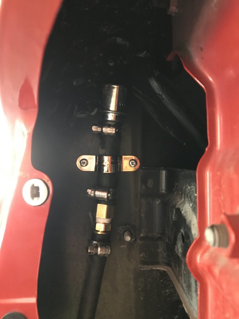

    Thanks for reposting your mod and pics Dave. Did you ever clean up the breather install? Looks a bit incomplete

    Differential Breather Mod Light Bar: 4 Cree LED lamps Bilstein 5100s Ride Rite Air Bags
    You lost me. Clean up what?

    Remember, that 'thing' Toyota put on the rear differential is NOT a breather. Do not put IT on the end of a hose, higher. Water does NOT get in through that anywhere it is located.
    That thing is a spring-loaded exhaust vent (lets expanded gasses out of the differential). It does not let water or air into the diff., no matter where it is located.
    The water gets in via the axle WHEN there is a vacuum created in the diff.
    A true breather breaks the vacuum by letting air into the diff. No vacuum means no water being drawn into the diff. The vacuum condition occurs when your hot differential suddenly drops into cool water.
    Is that clear, now?
