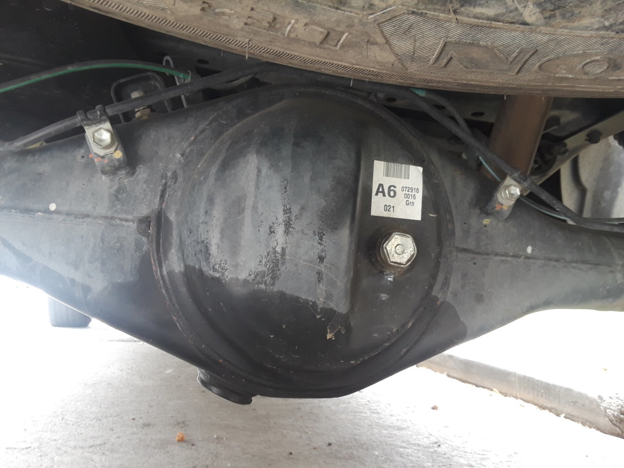

    Ill make this short:
    First time(@13k) wet spots appeared, dealer tightened diff cover and told me to come back if they reappear.
    Second time(@14.5k), dealer re-did the entire thing, meaning they drained fluid, used new gasket/hardware/fluid.
    Now @37XXX i noticed weeping at the same 2 spots. I am curious, will this be covered under:
    a. Good will sort of thing, since this has been documented as a problem in my truck
    b. 60k power-train warranty
    c. Out of pocket expense
    I will talk with dealer on Monday, but wondering whats a likely outcome for this for those that dealt with similar issue

    Still covered under original warranty - problem has not been remedied. Stand firm.
    Makes me think some micro crack or porosity at that surface interface.

    You would think. Looking for reasons why at same location, mucho miles later. Machined surface appears sealed and maybe is, but leak follows porosity really near sealing surface, close enough that sealant covered it for a bit then ultimately failed again.

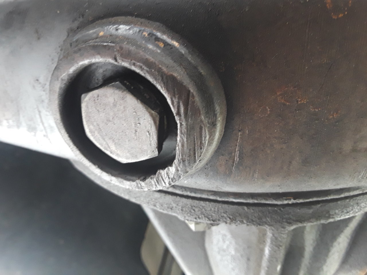

    Mine is also weeping for a 3rd time
    Dealer is claiming this may get claim denied by corporate. Saying the hit stretched the bolts. I am not sure what is going to happen now.

    Azusa, CA
    That's nonsense, I've dragged my diff over so many rocks I've had to reshape the drain plug with a dremel to get a socket on it, and my diff has never leaked around the gasket

    #195947
    41,586
    That was my thinking on it as well. Since they have fixed it 2 times before and the 1 time took 38 days of me not having my truck. I was told to bring it back in a 1000 miles.

    Azusa, CA
    Just sounds like typical dealer shifting blame on the customer, not surprising but always frustrating to hear.

    I ate the rack replacement, I will not be eating a diff replacement.:fistbump:

    Btw.... for all interested, this is what the entire diff looks like20190915_123608.jpg
