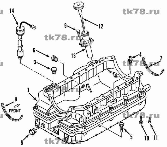

    We utilized #10 alot, would use UB instead of the factory pan gaskets and strip type rubber seals. Never had any leak issues if done right. And there were plenty of deep machine marks present.

    I don't recall Ultra Black being around back then. I was a mechanic from about 88 to 02. We used copper too, though some mechanics felt it did not hold up as well for filling in big gaps. I'm talking replacing 1/4" groove seals here with UB.
