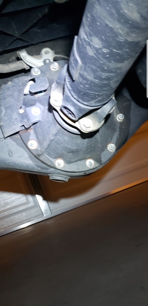

  20. May 27, 2019 at 1:52 PM
    #20
    bshammer0
    bshammer0 Well-Known Member
    Nov 6, 2016
    #201655
    3,366
    Brandon
    Nashville, TN
    2017 DCSB TRD OR 4x4
    Prinsu, TruckCovers USA, Coverking, OVTuned
