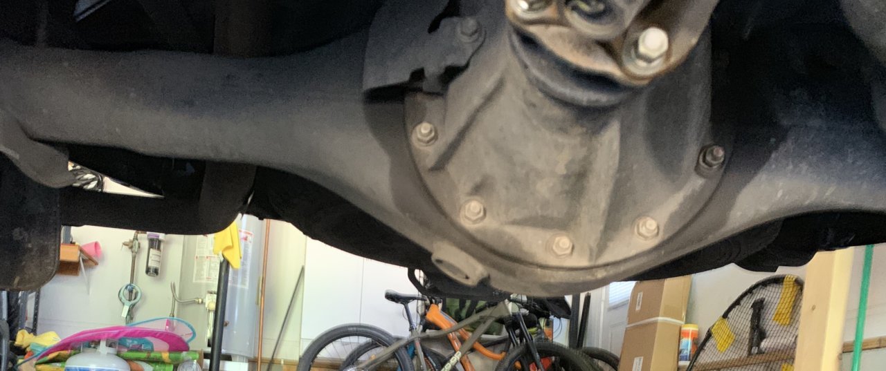

    Logged a case w/ Toyota, a field service rep called me and I dropped my truck off w/ the dealer. he approved the replacing of the gasket (a $8 piece of paper best I can tell?) which looks like took 2 hours of labor to complete. still seems unacceptable to me to have this diff weeping 2x in a year after they already did the "fix" to torque / gasket last year when it was weeping.
    We'll see if they got it sealed properly this time in a few months I suppose... At least it's documented as a recurring issue which should give me a leg to stand on if anything happens outside of warranty expiration.
