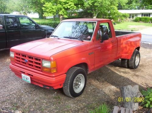

    Were you in 4WD? Or did you have a dually Ranger?
  8. Apr 15, 2017 at 8:08 PM
    #28
    mustangwilly
    mustangwilly Well-Known Member
    Jan 17, 2010
    #29484
    573
    2017 DCSB OR Quicksand MT

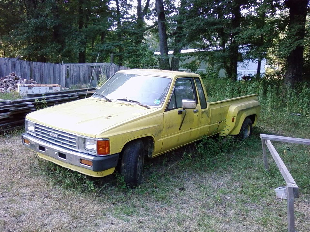

    A little wax and a tune up and that thing may be ready to go. That's probably a 22R in there. I bet that diff is just fine...LOL

    Ahh, now this is more like it. Got that space cab going on... Taking me back to my childhood!
