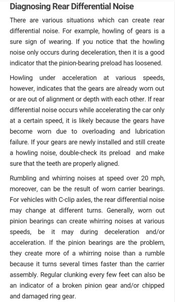

    Ledfoot 26
    Ledfoot 26 Well-Known Member
    Aug 8, 2016
    #194090
    258
    16 TRD OR 4x4 Barcelona Red
    • I posted this in the other diff thread a while back.20170406_210310.jpg.

    Did Toyota pay you to say all that? :spy: I agree with what you're saying but my point is until the cause is identified nobody knows for sure if the howl will or will not result in a catastrophic failure. It has always been my opinion that it will probably not cause an early failure of the diff. When I first had my diff looked at (with about 1500 miles on it) by the "special corporate engineers" flown in by Toyota, what do you think they told me? They said," Don't worry about it because if it fails it will be covered under warranty." My reply was, "Gee thanks but most likely this thing will continue to howl well past my drivetrain warranty and I'm not here because of possible future failure, I'm here because my brand new truck is making an extremely annoying noise that it wasn't making a couple months ago when I drove it off the lot and I want it fixed." Their answer; "well right now we're considering it a normal characteristic of the truck but we'll keep an eye on it." So here I am, almost 30,000 miles later and my truck still howls like Tijuana whore. Find one person with a howling diff who claims that they would have purchased their truck even if they had heard the howl on the test drive and you've either got a complete liar or a complete idiot. That's my gripe, it's almost like Toyota knows whats causing the howl (I can't imagine they don't by now) and has determined that it will not cause failure, so without worry of "catastrophic failure lawsuits", are just ignoring it to avoid the cost of fixing it.

    You could also flip your point the other way and ask, how do you know the Whoo Noise wont lead to a catastrophic failure?

    Because it occurs on decel, that's an unloaded state. If it was under moderate to heavy acelleration, then I would be concerned.
